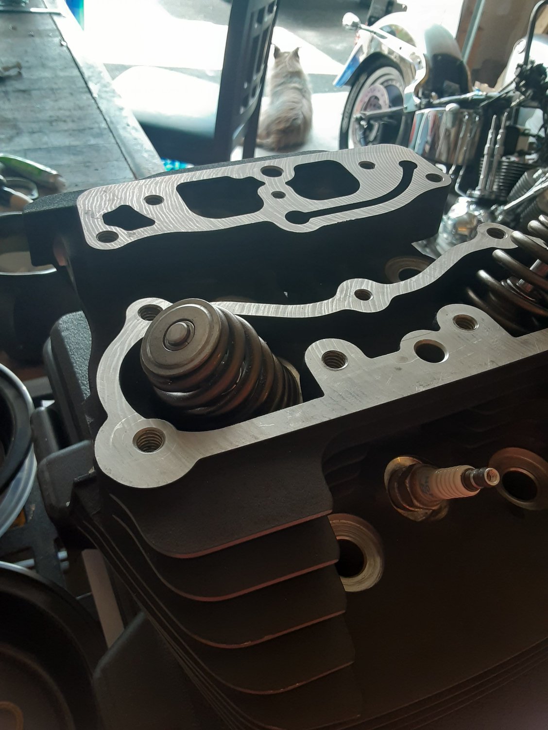

I cleaned up some roug areas around the valves and added a V shape ahead of valve stem on the intake side. This will be as far as i go with porting my own heads. Im sure it could be very easy to F this up in a hurry if i go to far. Time will tell if i did the right thing or not. New valve seals and the correct intake flanges have been ordered.

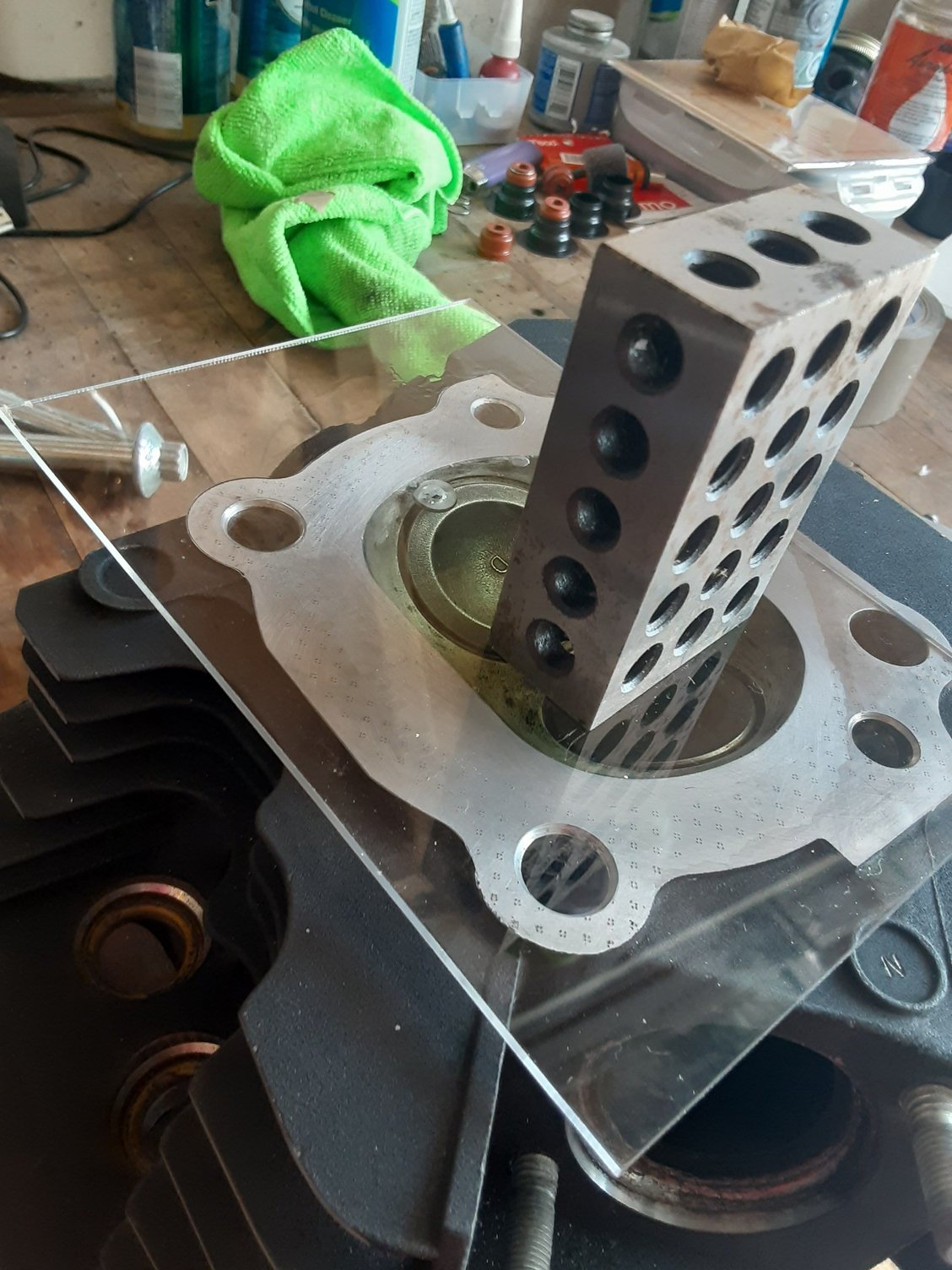

I think my white brothers E series will complement the complete project very well.
I measured deck height today; 0.005" deep in the front cylinder, 0.009" deep in the rear. (Measured without gasket, did not include a hypothetical gasket for that measurement either.
This tells me that in perfect conditions my cylindes will be within 3lbs of pressure, or 1.7% of eachother.
I plan to pick up .030 and .040" gaskets, will measure actual cylinder pressure with the 30s in first, if pressure is top high, I'll go with 40s.

Today i put new valve seals in and reinstalled the lapped valves.
Measured cylinder head volume. 86cc. Now om waiting on a gasket kit before i can move any further.
