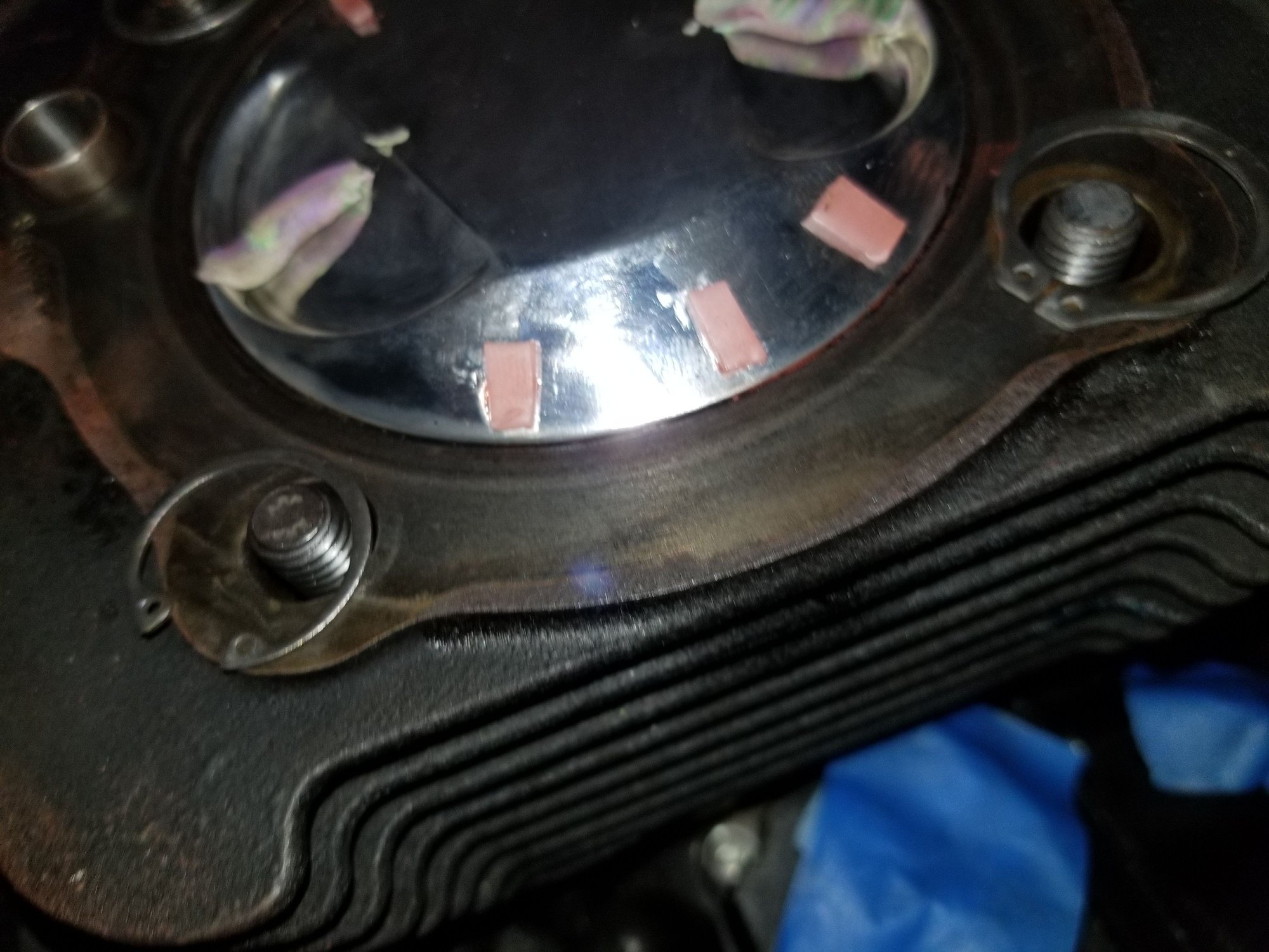

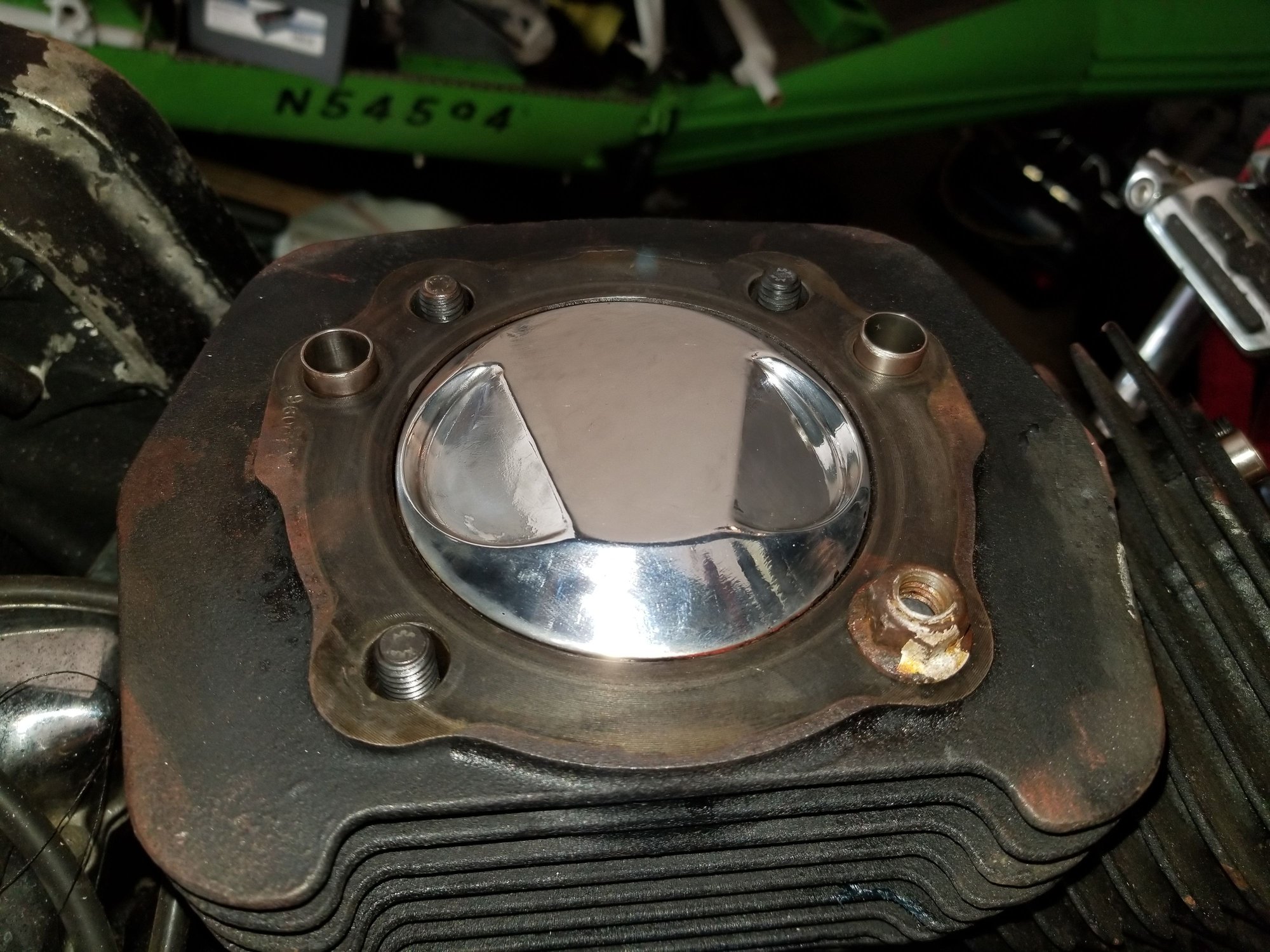

Pistons as they should be.Doing final mock up .Need to always check valve to piston clearance !

Those are 40 thou shims on the studs to represent my head gasket when installed.
I know they look like retaining clips...they are not............ LOL
What I do is assemble the valves using very light springs from the hardware store,
as want to be able to "feel" what is going on there when I roll it over in high gear by hand.
I will post pics and results latter.
can get nothing done sitting here.

Note the tiny whimpy springs for mock up.
the clay is in the valve pockets getting ready for roll over once push rods installed
