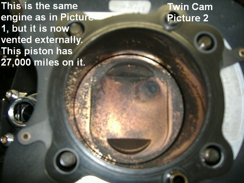

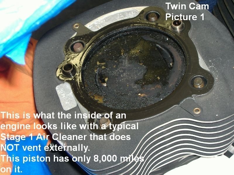

Not Scott but he will tell you the same; bigger hole will allow more to drain through. Seen too many dynos with breathers vented to a catch can (not sealed so fumes can exit) with no loss of power over internal venting to buy the donk 316 postulate that venting to the atmosphere results in a loss of power. If you "don't buy the BS about oil residue on pistons until you have 50,000 miles" on the motor; check out the attached photos.
