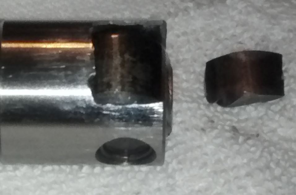

A collapsed lifter will not give you .200" clearance if anything it might give you a hundred .100" Gap but as Scott said a roller going? Yep that'll do it. Also an adjustable pushrod collapsing and or a bent valve. those are the only three that would really cause that large of a gap.. As suggested work from the cam chest up.. if no evidence there then bring cylinder up to TDC and put a little air to the cylinder a bent valve will be very noticeable..
Thanks, pulled rocker assembly, pushrod straight. Pulled four bolt on lifer cap to pull lifter but cantc remove.
Indicates failed lifter roller which also means cam lobe is probably damaged. Pull the cam plate/cams and the lifter should drop out from the bottom of the bore.
Sounds like a blown lifter roller.

On 2013 110 Scream'in Eagle, will lifter come out through push rod hole.
It should slide right out. Probably looks like this.

Scream'in Eagle
Hits a bar across base

Yeah, If you have the tappet cover on it won't.
