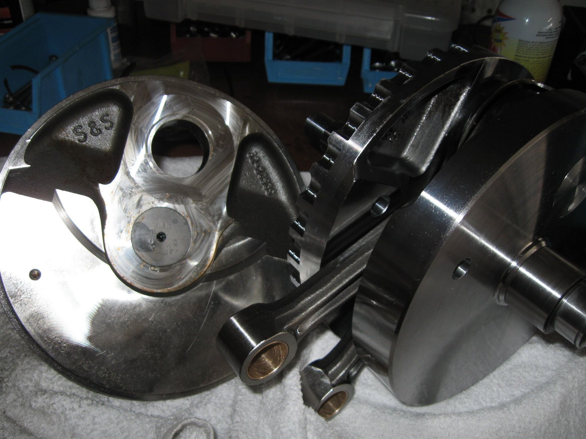

Sorry Paul, That is not an older flywheel. It's a 3 piece flywheel.. Look at the title. Older flywheels were 5 piece. They had pressed pinion and output. Here is an older flywheel half on the left and newer 3 piece on the right.. Sorry not I'm not destroying the one on the right to prove a point..

BTW, Original 5 piece used aluminum plugs on the crank pin to seal the oil passage..On the 3 piece they started pressing in steel which is exactly like the dark horse pro-plug.
"Designed with increased cross-sectional area for increased crank-pin clamping force – No welding required!" (they are basically comparing to their older 1.5 inch pin.HD TCs have always been 1.671.)
Gee, I wonder if going from 1.671 to 1.750 increases the cross sectional area. That 's what HD did on M8 compared to the TC.
