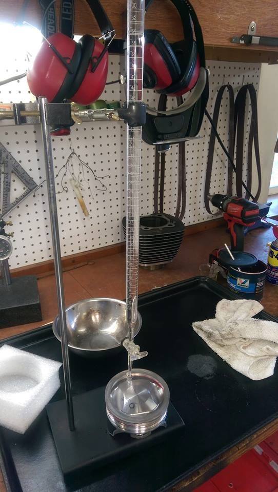

What kind off accuracy can you get with a beaker? 5 ml?
The one I use has a valve and is graduated.as in the pic.
I am sure it is within a whisker thickness of a flea fart as I get results with minor changes and is repeatable.
The biggest problem is just accurately filling the chamber...any dribble or screw up, means start all over .. again.

Here you go.. Just did a set..

I think that is exactly what I use.
Is that a piston for a turbo engine there?
