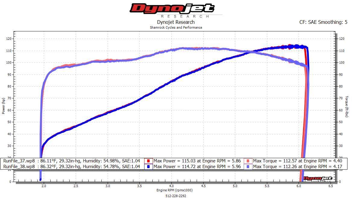

My 98" results; these "little" motors will make power.
Old thread, but what combo do you have going on here? Ready to bump my little 88” up...
I’ve got an 04 FXDXI and running S&S 510 gear cams with thunderheader and air filter.
Thinking 98” bore with 585ez cams.
Debating if I wanna dump the extra for heads, I also don’t want to get into compression releases. I like to just hop on and go.

a 98" kit with 585 cams will do these #`s no prob (we got very close #`s with a kit we sent to a customer in Ky with 10.0-1 compression & S&S 570 cams) make sure you get headwork done,it will be the key to achining the #`s your looking for

Old thread, but what combo do you have going on here? Ready to bump my little 88” up...I’ve got an 04 FXDXI and running S&S 510 gear cams with thunderheader and air filter. Thinking 98” bore with 585ez cams. Debating if I wanna dump the extra for heads, I also don’t want to get into compression releases. I like to just hop on and go.
Cyclerama 595 gear drive cams; CP 6cc dome pistons; 57mm Kury T/B; HD Street Performance heads and Bassani Pro Street exhaust with 11:1 static/212CCP. You might get those numbers with a different cam set but not without a very good set of heads.
[/QUOTE]
Ran your current set up for 18 years.
And while I have no dyno sheet, I will say that going to 98" / Heads worked/ mild C/R increase / 570 cams , made a decided difference and was worth the effort and expense
JMO
