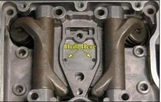

You will have to take the tank off to do the heads and cylinders. There is some beveling you can do to the breather holes in the rocker boxes and I'd put in the Rockout rocker inserts to help with top end noise.
1/8" drill bit
