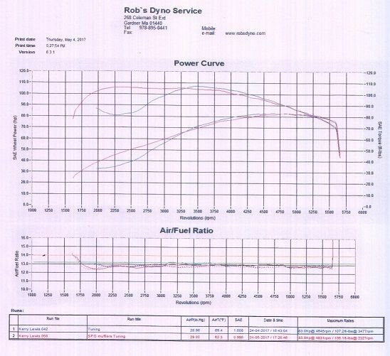

Below is my dyno sheet with the 551 cams. (Red Line) You can see why its great in the mountains from idle to 3,500 RPM's which is where I ride. Hopefully someone can post their sheet with the MR103, 570-2 and 48 as a comparison showing a curve that climbs from 2200 / 4500.

Thanks man, that looks very nice.i like how quickly the Two builds.

Looks like a muffler change during the tuning process. Shows just how important it is to have the right cam AND exhaust combo.
