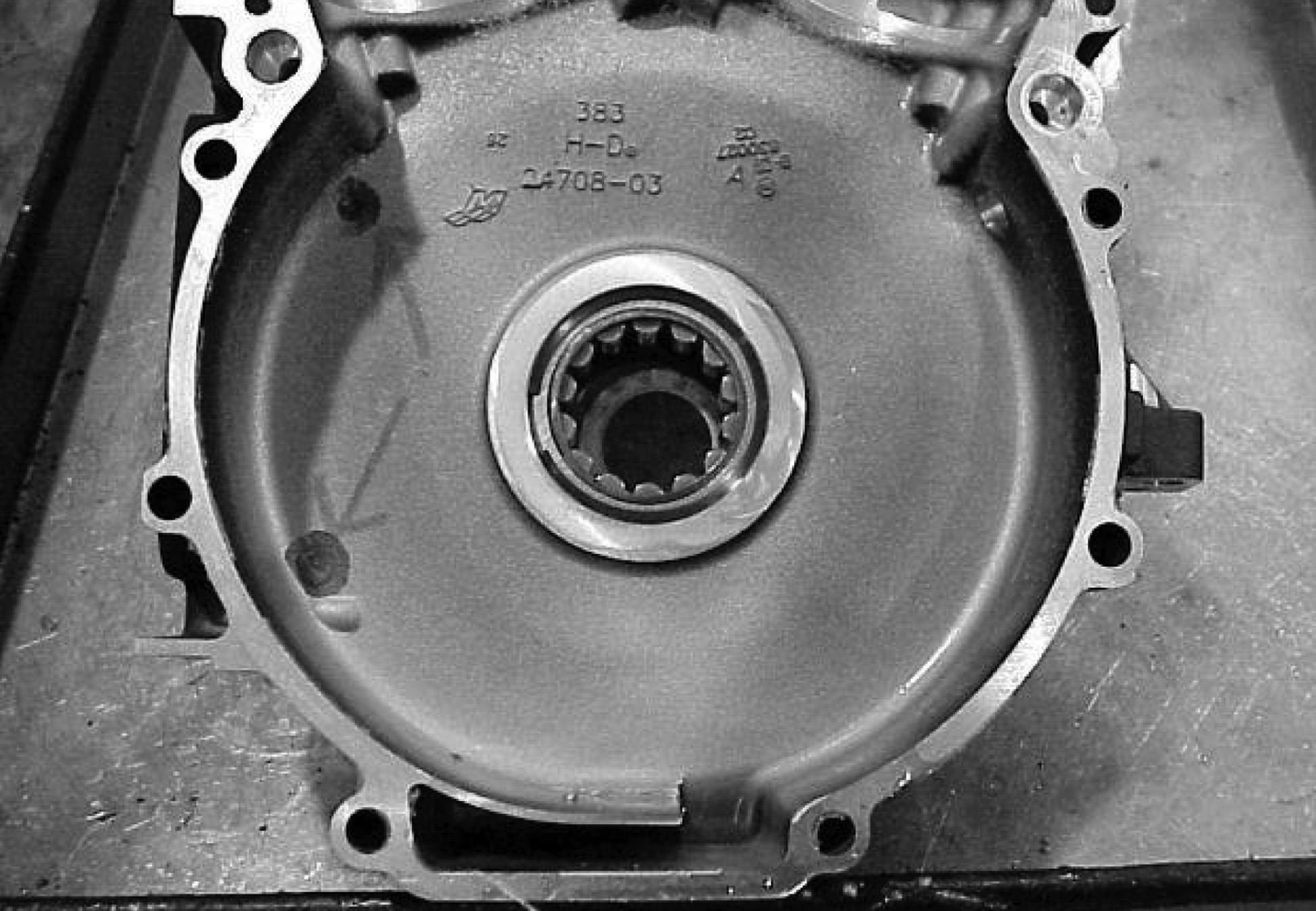

They put the Baker transmission in without removing the inner primary? Reason I asked about the inner primary being off is sometimes people put silicone into the bolt holes where the primary seals to the case instead of around the bolt holes and blow out the engine case and then get transfer. Pic attached.
For a high amount of transfer though, I would be looking at the crank seal before fretting about internal damage. Those seals and spacers do not last forever.

Ed, WOW! They made a mess of that case! Awful. I actually checked all the bolt channels to make sure none were "through." I use a feeler and and then a low pressure air nozzle. The bolts were dry when I removed them too. (inner primary and stator) I just find it odd for a seal to go that quickly. 25K and operated regularly. Time will tell. Thanks for your input and help.
