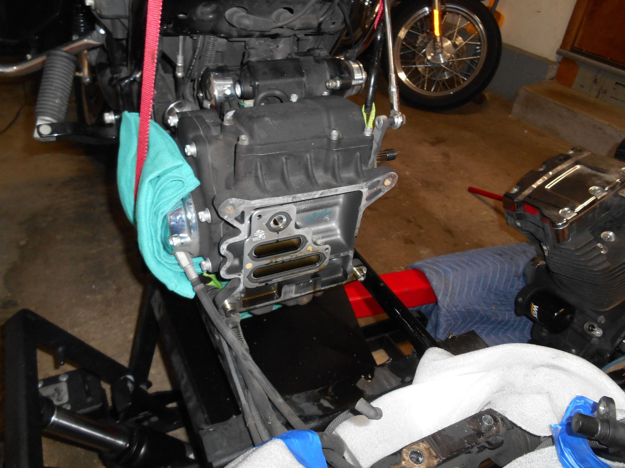

The engine and transmission cases are different on the A motor (among other things). A post 2007 A motor (2006 for Dyna) won't bolt up to your previous generation. Later A motors use a pass thru oiling system as opposed to external hoses. Below is a pic of the pass thru oil system on the 4 3/8" stroke Twin Cams.
