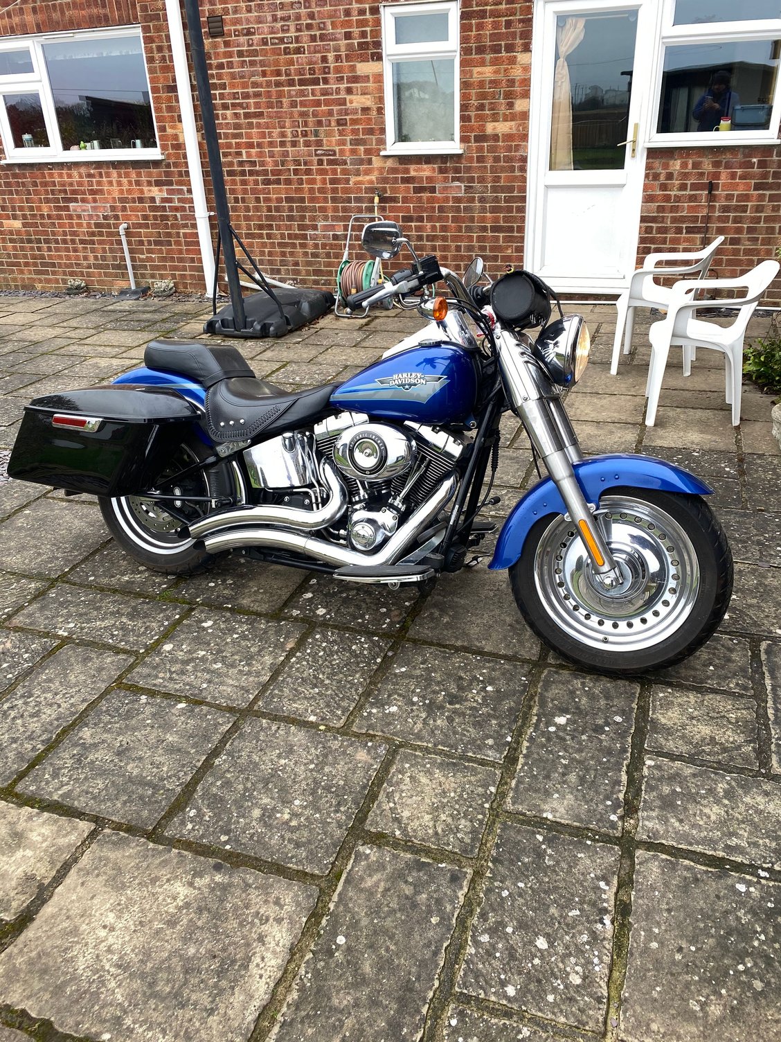

Hiya my 2008 stage 1 Fatboy with big radius pipes started stalling as I pulled up at the lights
I saw about a dirty air intake so cleaned this out with carb cleaner and everything seemed good
The bike ran fine with pillion and luggage on a 500 mile run without missing a beat
Then the next day the problems re occurred and cleaning the air intake would not help
As this happened on a ride out we attempted to limp back where the symptoms worsened to only firing on one cylinder and occasionally both at higher revs before finally giving up and stopping running altogether having used a surprisingly large amount of fuel
On inspection there appears to be a good spark at each plug
a strong smell of petrol
I have noticed that when the ignition is switched on the whine from the fuel pump sounds different possibly slower
Any tips on where to start looking would be gratefully received
Thanks Dave
