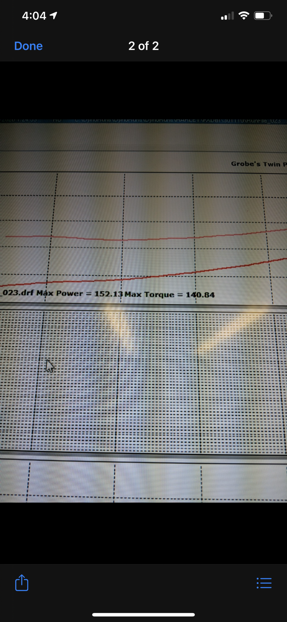

First pull, no tuning, 65 degree room temp, 100% humidity (rainy day), made 140hp at 5500 with tq showing no signs of falling off. He said it should be into the 150s no problem on pump gas.
Just heard from him again. 152hp, 140tq. at 5700rpm. Just added a little more fuel up top. Timing still needs adjusted, will knock on the door of 160hp STD
Sounds strong-👍
When you get a chance, have him email you the Dyno sheet, and post here so we can see when and where the power comes on....

Will do, we will also check CCP after the full pull Saturday when the humidity isn't crazy high.
We're at 110 ft lbs at 2500rpm, still a bit more to go maybe 5 or so. My 107 was about there and it was plenty for my Dyna with the 30T compensator sprocket.
Heres the last pic he sent me. These #s are at 5700, STD. Peak tq at 5000rpm, math shows at 5700 we are still 140 tq.
