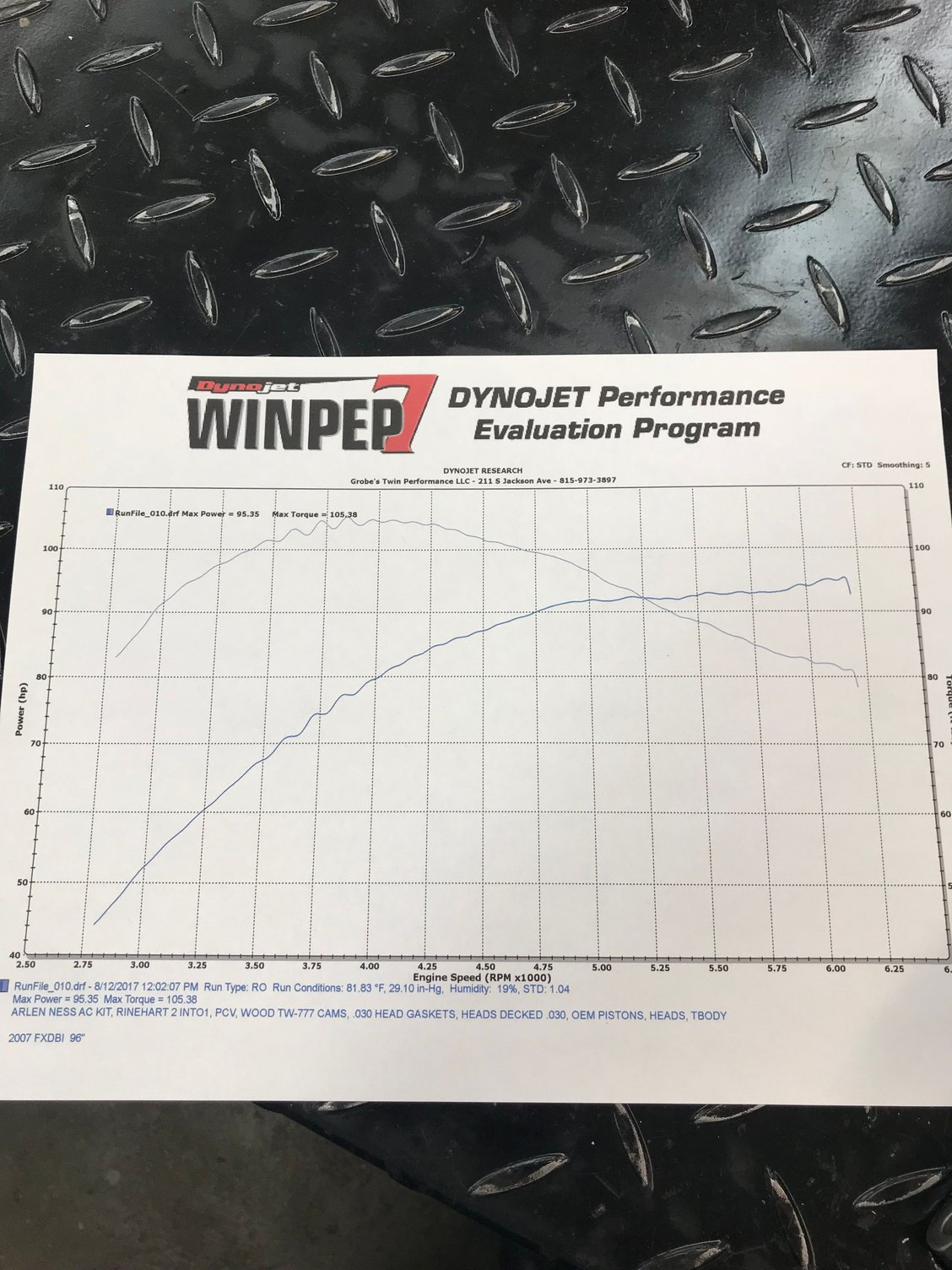

Originally Posted by Big_O
Heads decked .030, .030 gasket, valve job, and the 777's put me at 95/105 STD with a Rinehart 2-1 and stock injectors. I don't think your 100hp is out of reach. Attached is my dyno run.
I would've thought the 777s would've peaked a little later and had more on the right. I wonder if it's your exhaust? I'm not familiar with it or where it pulls best. The hp really hangs on and want to climb right at the end still. I always thought that was an indication of the heads not flowing enough holding it back tho. Maybe Scott or someone more familiar with the dynamics will know. It sure seems like something is holding it back.
There is a very slight dip in the torque around 5300, 5400 then it wants to come back but just can't recover making me think it's the exhaust not playing real well with the overlap there or it would be close to breaking 100hp. It does come back right at the end at 6000rpm.
Not that it's bad. Just not a curve I expected from the 777s.

If you are now thinking about a 124 I'd definitely wait. You are going to be spending money and still not be happy with it anyway. You will be happy with a 124 though lol. Also in my experience I've never seen a bolt in cam only upgrade make 100 HP. Headwork is needed for that. Usually top out at around 98.

The 777 needs 10.4 to show off.

I ran the SnS570 and 777 in a 103 set to 9.9 to 1 with heads and the 570 sucked worse. 777 wasn't too bad. Fatcat pipe with quiet baffle. I will say say that the 777 is more fun at 10.4 in a 107..
Add. The 570 was pretty much dead below 2500 rpm.

What made the 570s suck worse? It's made for CRs of 9.2 to 10.2.
I'm really not concerned with anything below 2500rpm. Neither are going to be all that great there. But depending on what you did to the heads, maybe velocity was hurt in favor of volume?
Just spitballin'.
I'd probably be more inclined to go 999-6A rather than the 777 tho.

Too much exhaust duration. Causes over exhausting.
I would not go 999-6a without a compression boost and springs.

But I've seen bone stock 95s doing 95+ hp and 105+ ft. Lbs with the 570s coming on from 2800rpm. Its not the exhaust duration so much as the short intake that concerns me. The 252/252 of the 999s would be much better.
If you were looking for a cam to pull from 2000rpm up, you definately picked the wrong cams. Both of them.
