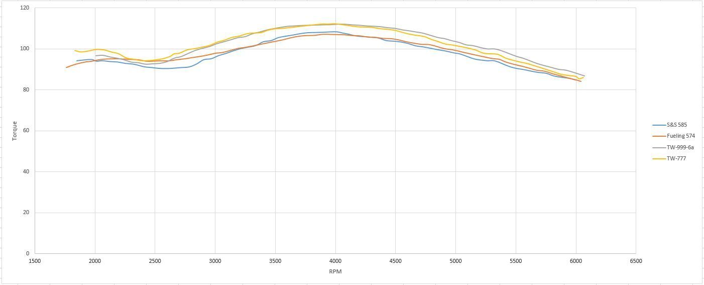

Pick your poison...
I digitized all the tq curves on the fuel moto study. Here is 4 cams compared.

Originally Posted by Big_O
Pick your poison...
Thanks.
Now those are what I call dream torque curves. What's not to like? All of them respectable but the 2 woods cams do stand out. I'm surprised just how close those 2 really are.
Now bump up the compression with a 107 kit in a couple years...
What tuner, Max Headflow?
