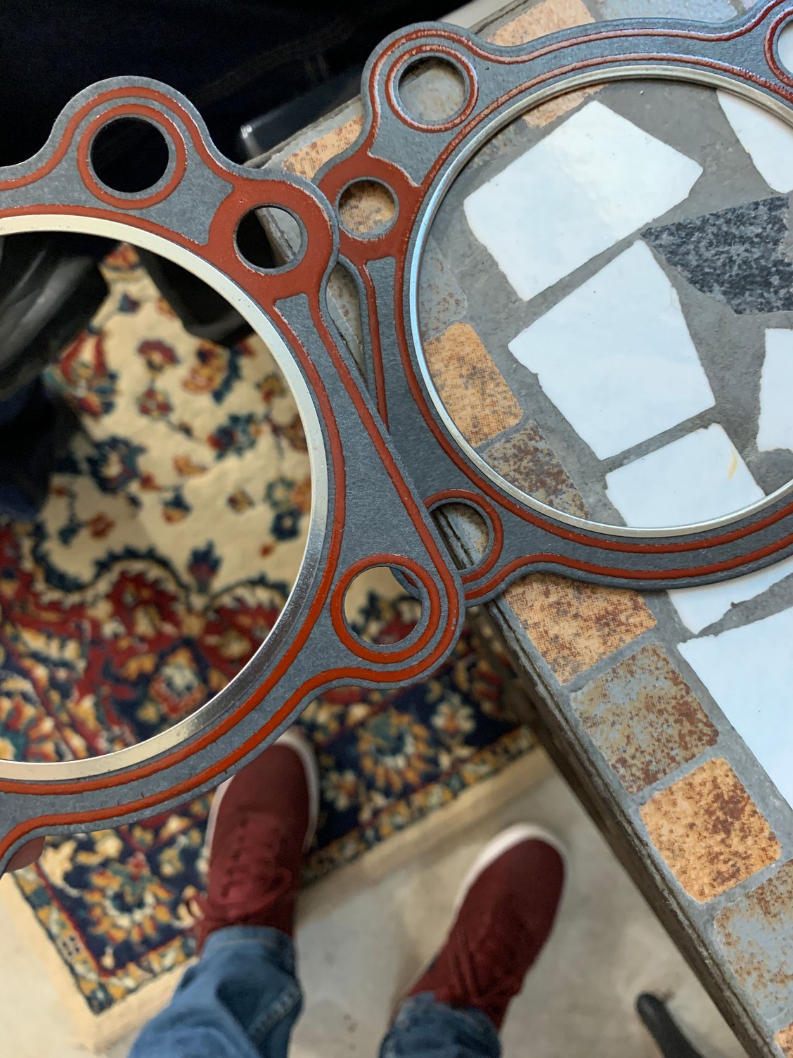

Bought some James Gasket's for the top end rebuild and following the service manual for the step by step. The James Gasket's didn't provide any instruction on the orientation but clearly looks like there is a difference between each side on the Head Gasket. Have a call into James, but haven't received a response.
Anyone know if if the larger exposed metal should be facing up or down?

Put the wide side of the metal fire ring up, like the left one in the photo is now.
They'll work either way, but the narrow part needs to fit against the cylinder liner, otherwise they tend to eat into the head over time.
