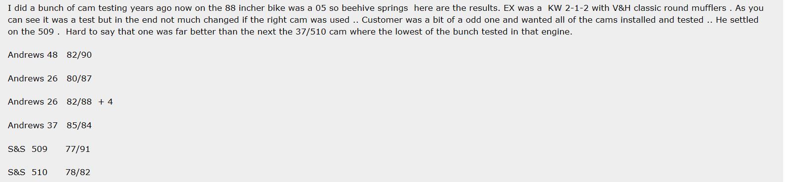

Really only two choices for the 88; S&S 509 or Andrews 26. The "I" in the below attachment is not me; pulled this from another forum, thought it worth archiving for future reference.
I saw that somewhere recently.
