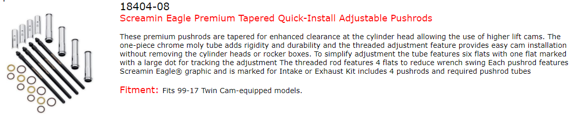

Putting these on my '03 FLHRI...Stock cams, stock lifters, everything's stock except I just changed out the cam plate to the SE plate with hydraulic tensioners. I'm reading that these pushrods are 24TPI, and I'm also reading that they're 32TPI. Which is correct???
18404-08

There are 3/8 X 24 - 1/2.
