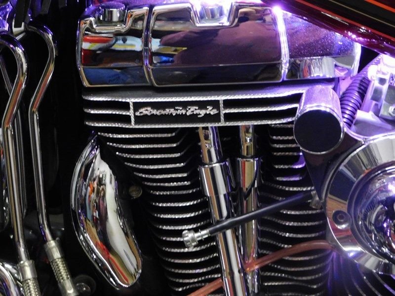

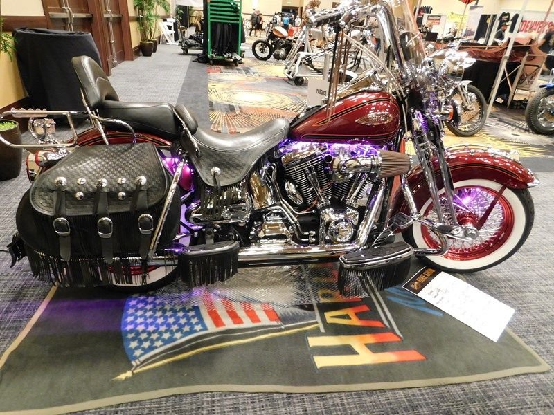

Smile 2000 Heritage Springer
I purchased the bike in June of 2020. The motor change was done by one of the previous owners. The documentation I have is that it was done by a Harley shop in Bedford, Texas in 2018. It is a carbed, CNC ported, Screaming Eagle 107 ci motor, including a Screaming Eagle six speed transmission, also installed in 2018.
