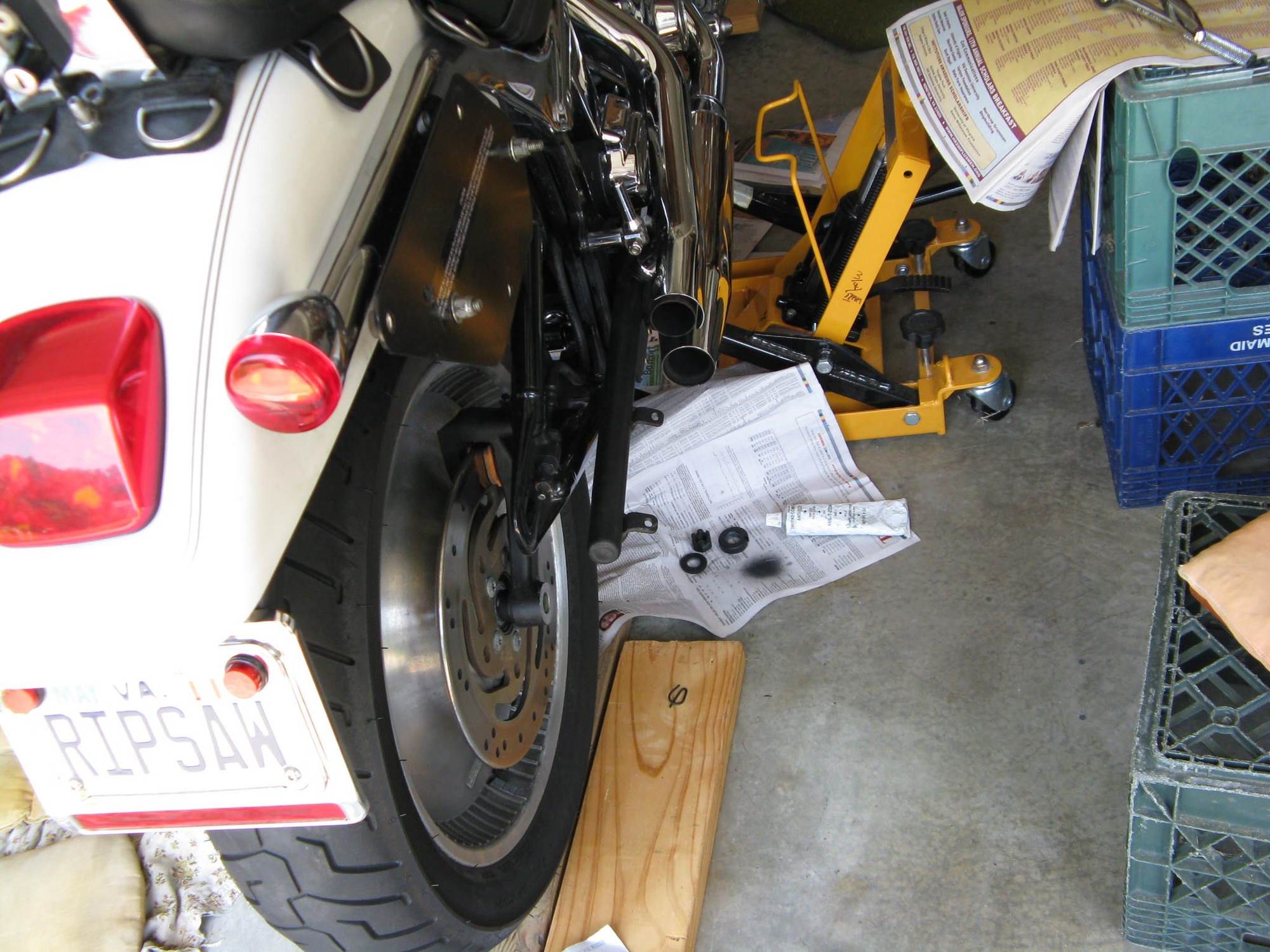

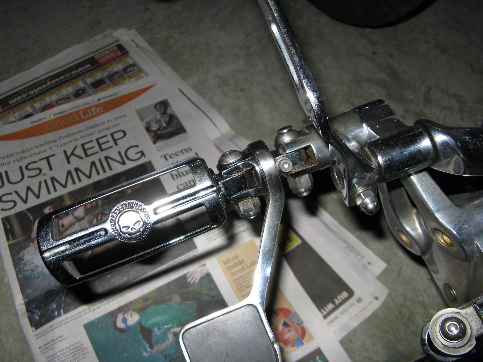

Think my bars may be of interest here. Also some other details. Don't know the exact part number since they were purchased at the Harley dealership parts and fit a seat or bars and then installed at the service department along with the SS cables. The original owner was much shorter than I. He had the SE package installed also. Front shorter springs but the same capacity by reducing the space between the coils and longer rear shocks (longer lowers on a Softail). Shorter stand. Also, a Corbin seat that he returned to the manufacturer to lower. (which they did by removing padding down but adding some to move it forward.)
Bars I think were OEM from a bigger Harley FLH cruiser. Not sure what designates buckhorn. I sold the original Duece bars but as I recall, they were slightly higher, much narrow, and not nearly as far back in reach. I sure would not want apes. I can see them getting you in trouble in a turn if you ever make mistakes entering one too fast. These bars work well for my 6'3" frame. I padded the seat with a custom leather pad I sewed up. (the tag you see came from a D ring Willie & Max throw over I cut up for my rear tie-downs for Saddleman carry bag. My helmet lock is courtesy of Yamaha. Had a Harley one but it sucked down on the tube. Who wants to cook your helmet and hang it on the ground.. Ha. Also added the fwd controls and spurs. So that bar reach became perfect.
Bars do make a difference. I was working on a 40K SE Dyna. It had straight bars. Just testing my work hurt from driving it a short distance. Scared me. It had a locking clutch that was a pain. Idle was crazy. No power at first and then it felt like a bomb went off. The shifter and brake lever position were impossible for me other than lifting my whole leg. Needed illegal in VA earplugs on it. I would not have given $40 for it.
My risers are very similar to stock Duece but the cap bolt spacing is wider since that is how Harley designed the tac mount. Why? Answer $$.
I reinstalled the front longer springs. Set the longer rear shocks to the softest position (a pain). I would have put the originial rear shocks on but I liked the look of the taller front and lower rear.. However, they bottom in back if you are not careful with that. That is annoying. The original owner had them set hard since he rode two up. However, to me who never rides two up found it harsh. It's just a pain and I have rever tried to go back halfway.
Some dimensions on my bars. apx.. thru risers is 11" to the turns. The turn ups are 7". Then the length from the top is 11". Duece riser kick bac 1 1/2" and are 5 1/2" off the tree. So there I have about almost 9 1/2" rise to the center of my grips were I have bars angled. The span to the center of grips is 29". Lot of leverage compared to the original. (You only need leverage at slow to no speed...and a Duece with its rake needs more then let's say a Fatboy. (When I get on a Fatboy, it's like power steering) Also, I have my fall away at a minimum (lose and no preload on bearings..just no play) At speed with the wind and trucks, you can drive it forever on the interstate just leaning to steer.

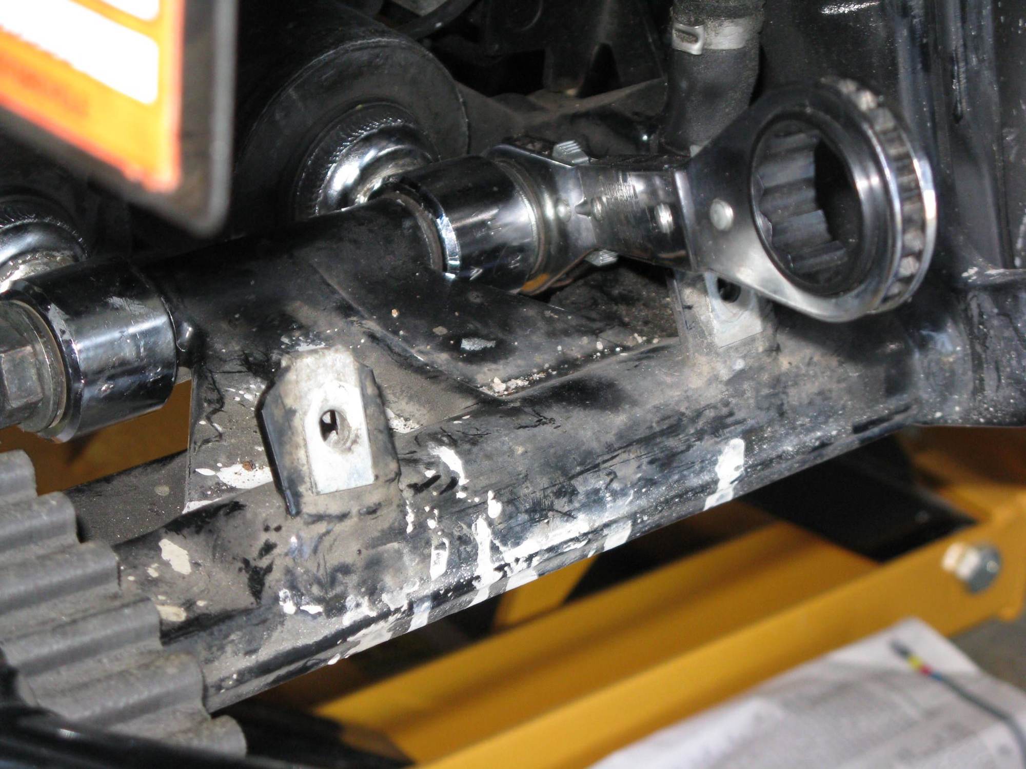

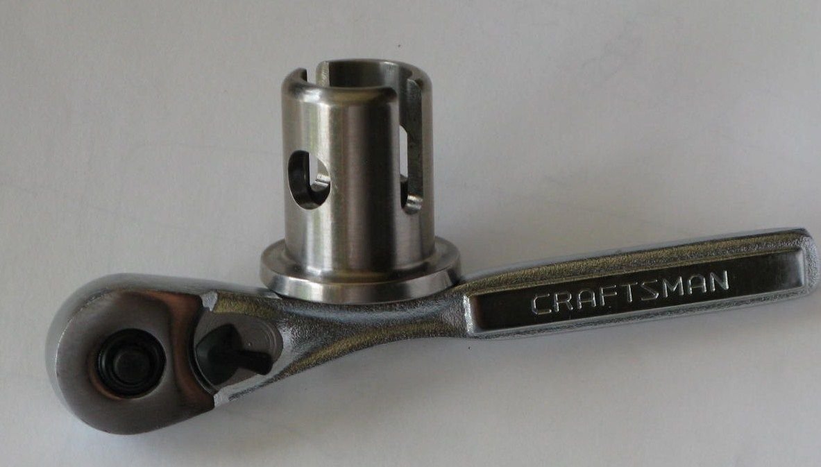

Those last three shots are a device I came up with to easily realign the rear for perfect belt tracking using my caliper after tire changes or other maintenance. Also, my axle has flopped so mufflers don't need to come off. Last one is you will have to guess where it goes. Also special locking lug on jiffy stand from K monel is in one picture.
Other changes. Rear red run and brake lights. Bootleg SE engine badge for 50HP for $10!?? Haa. Harley Star wheel. Rear plate mount trimmed to fit the plate. (Harleys version of that was huge and then went to ebay. Chrome belt guard. Harley bags and 100 Anniversary shield. 96 Nighttrain brand new takeoff exhaust system. I drilled one 5/16 hole thru the center plate that opens the inner baffle straight thru. Sounds just like you cammed it but not loud. Came with Python long shots. Went to eBay. . . Led rear brake light to take some load off brake light switches. The bike is on the third hydraulic and second front micro.switchs. No sense for me doing signals sense you need resisters.
