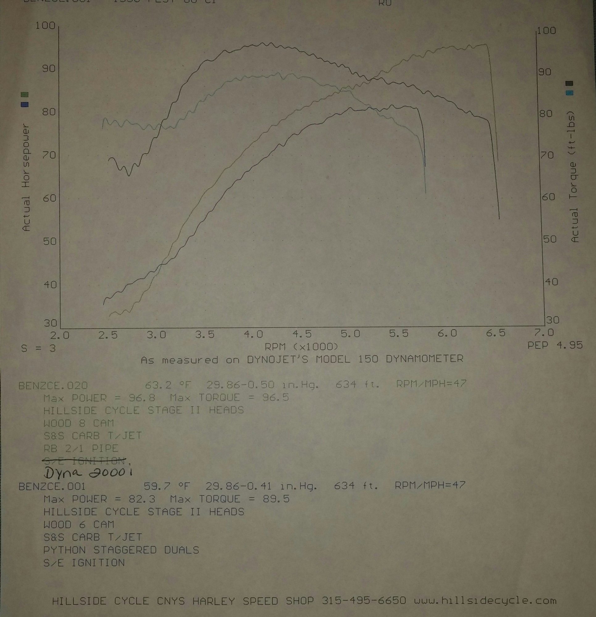

That exhaust SHOULD do very well with that overlap and really help with cylinder fill. Especially low end where those cams need help the most.
I say "should" because I haven't seen any kind of numbers or heard of anyone running it here period and I'm looking forward to seeing how it does. It uses the same patented anti-reversion baffles the Khromewerks HP Plus slip ons use that have been around for forever. Those baffles have been around for decades. Better than most 2in1s. Same patent number.
Very pricey but could prove to be one of the best 2in1 exhausts out there. Should sound kickass too, especially for a 2in1.
I'm betting you wont see that big dip in torque the dyno above has.
I ran the Khromewerks HP Plus slip ons on a Sporty build with cams that had 56° overlap, 256/256 duration was doing 80ft.lbs at 2300 in a 1250 and up from there
