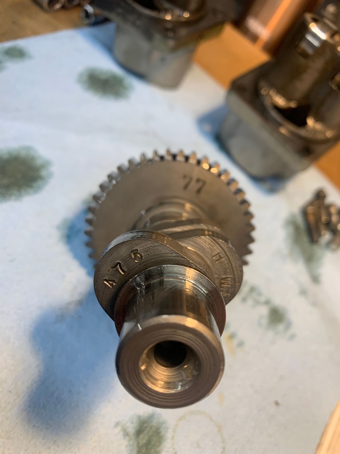

I’m tearing down my 1985 FLTC to freshen up the heads and barrels. It appears to be a mostly stock EVO but I found this cam and adjustable pushrods and I can’t figure out what it is. Though I’m pretty sure it’s not stock. One lobe is marked “475” and another with “HW”. The gear is marked “77”.

looks like a re ground stock cam,post a pic of the lobes,from this pic the cam looks to be junk anyway

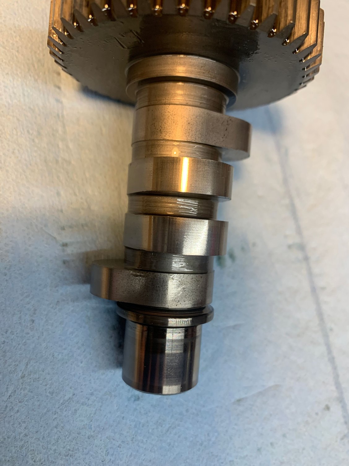

Here’s a couple more photos of the lobes.
I was planning on putting in an Andrews EV27 and fresh lifters anyway so if this one is junk I’m not too worried about it.

must have just been the light in the first pics,looks ok there.

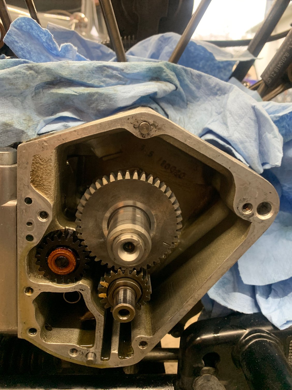

I would like to see a pic of the face of the drive gear as it sits in the cam chest.. Is it possible it's a shovel cam?
it’s possible though I’m not personally familiar with shovelhead cams.

Most all Evo cams that I am familiar with have a groove in the face of the cam gear..Yours does not, which would indicate a pre 77 cone shovel cam. Do you know what the base circle size is and the total height of the cam Lobe? Knowing the 2 would give you lift and maybe a clue as to who might have manufactured it.. Post measurements of both intake and exhaust..
Also with a degree wheel on the sprocket side of the crank and a dial indicator on the cam lobes you can record opening and closings of both lobes as well.. This is if you really want to know...
