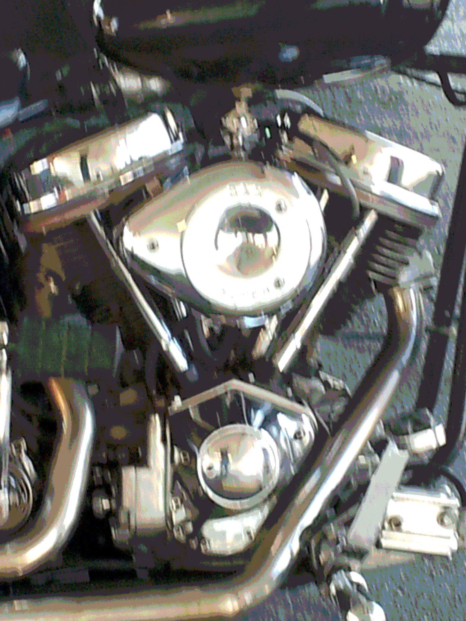

my dad built this from scratch and when he passed it became mine......
delkron bottom late shovel
1340 universal shovel pan cyclinders
std dual plug panheads with oitside oiler
it has solid lifters with adj pushrods
qquestion is upon taking it apart i noticed the stock h cam that was in it. had a bad lobe what i was wondering what andrews cam can i get that is still easy to start as it is kick only and still get good pull all the way up i know the heads will take up to a 450 duration

An Andrews J grind would be a great replacement cam.

Thanks for the info Scott I was looking at them and just wanted another opinion I will check it out and make sure it's good with solid lifters

Posts: 12,084
Likes: 829
They are.
We have those on the shelf here.

Hey Scott that looks like what I'm going to go with found them on Amazon for 131.00 just wanted to make sure it will fit into the late model 77-84 I really don't know what the difference between them is

The Amazon folks should be able to help you.

Sarcasm noted.
OP - Buy from the guy that actually can help you.
