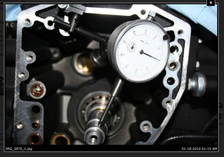

10 ultra with 60k doing chain drive cams myself (Andrews 48) bike runs flawlessly. If no intention to consider gear drive is it necessary to check the run out? I don’t have access to appropriate gauge. Unless I ask an Indy to do a house call...
I disagree with the naysayers. You wana know if things are starting to go south, or do feel good about sticking your head in the sand? Ignoring a potential problem won't make it go away, but if you never go far from home or think you'll always have cel service and don't mind knowing if you're riding a hand grenade--just ignore it and bank on "Luck". It don't mean you'll have to go deep and spend a pile, but it's nice to get a baseline for the next time you're in there so you know if big trouble is brewing.What does it cost to just check?

I can't disagree with Skills or 98hrfb (no disrespect but he needs a shorter handle); of course getting a baseline is a good idea. However with 60K miles with no indication of a run out issue and considering the OP is planning a cam only upgrade with chain driven cams, not measuring run out is not a show stopper IMHO. The OP can take a look at the oil pump, cam plate face, pump gerotors and if all is within service limits, a run out issue is not likely. Replace the tensioners, the inner cam bearings, install the new cams, get her tuned and ride.
So he OP measures and run out is .005" are you guys suggesting he should split the cases for the cam upgrade? Or just get the baseline for future reference and proceed with the cam upgrade? I ran a set of TW44G cams my last 95" motor (104TQ/96HP built years ago. Run out was .0025" when I installed them and .0045" 35K miles later when I tore the motor down to build a 98" "hotter" motor. Not sure how many miles I had run at .0045" but there was no indication that the run out was a problem; motor was quiet with typical gear drive bit of a whine.
I can't disagree with 98hrfb on cam selection either as I know nothing about the Woods 222 but have seen a few dyno sheets and have installed a few 48s in 96" motors when Andrews first released them. The 48s work well as a cam only upgrade and almost everyone I know that did that cam only upgrade to a 96" was impressed enough with the increase in performance that they went the BB route within 6 months or sooner if funds were available. Since the OP has that cam in his sights, I see no reason to point him in a different direction.
Now when the time comes for the 107 upgrade, more compression, head work, more TQ/HP, definitely check run out and then consider whether or not the crank should be addressed.
I don't disagree with being patient and going bigger/badder at once but believe the cost of the bigger/badder plan may be prohibitive for the OP at the moment. Not trying to start a debate on the value of checking run out; just providing another point of view specific to the OPs situation.

Just trying to understand this train of thought. If .012 is the max for chain drive and .05 is the max for gear drive. I'm thinking he's probably ok since the bike was delivered within spec with chain drive cams. But if we're saying his crank could have developed more runout after 60,000 miles, more than than .012 spec, then that means that everyone who installed gear drive cams at less than .05 could also have developed more runout as they put on miles as well. Does it not? So we're all riding potential hand grenades, lol.

As it turns out been checking dial indicators and it’s not a big deal to purchase a gauge and mock up a testing apparatus. So I’ll go ahead and see where the run outs at. But at 60k miles her start up pressure is 30+ And warm idles around 12ish. I’m not overly concerned.
Short answer is no; we are all not "riding grenades". First, the generally accepted max run out for gear driven cams is .003" TIR, not .005". The MoCo has established that .012" run out is the threshold for warranty purposes which, I guess, makes .012" also the max acceptable run out for chain driven cams. I think the question of whether run out will/should increase after installing gear driven cams depends on a variety of factors but should not be accepted as a general rule; too many variables. Cranks have been tweaked from heat soaked kick backs, sudden and hard decel or braking and, of course, from general abuse.
I, for one, have not suggested that the OPs crank run out has increased over the 60K miles he has rolled up; we will never know. I don't believe the run out, whatever it is, will increase with another 60K miles even with the cam upgrade provided that none the three circumstances referenced above come into play; there are others of course. It will be interesting to see what Weeboy finds and how he plans to move forward. I have attached a photo of one way to set up the dial indicator for the measurement since I don't believe Weeboy has been down this road before.
