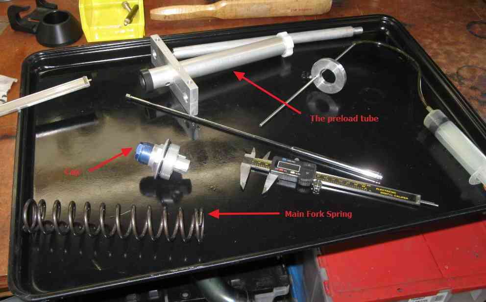

It's no wonder these front suspension sucks so bad...... I never seen such a short Spring in all my life and look at the size of that plug holy ****.... Like I was asking before about fluid levels not sure how much these 49 mm tube take... I don't have a manual but the fork oil is at a level that is only 9" from the top of the tube... Is this normal.?? I'l measure what I take out but it seems like a lot... I am used to anything from 10.5 to 12 oz a leg but that's the older 41 mm suspensions.. check out the pics.. Holy ****... Anything would be an improvement...
Oh and one more Thing I forgot to mention was the fork oil that's in this is like ****ing water... Now I see why these ride like ****....
One of the best forks I own has short springs in it..

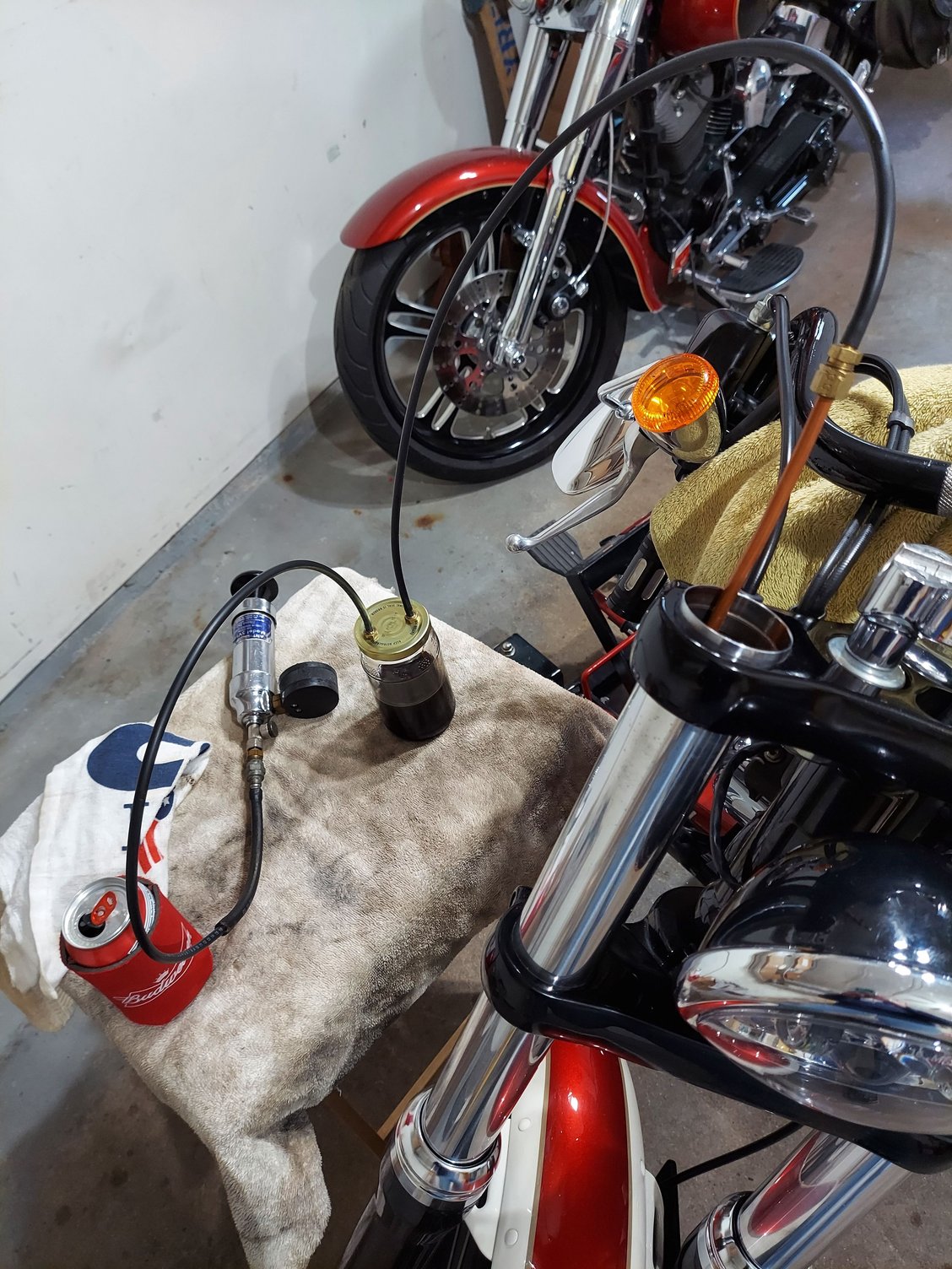

I already had a vacuum pump so I decide to make own little canister (a jelly jar) with some of my pneumatic connectors that I use at word in HVAC... in works pretty good to suck the oil out of the tube...

OK, thanks Max all see what I need to do... I did take out 28 oz Just on the one side
