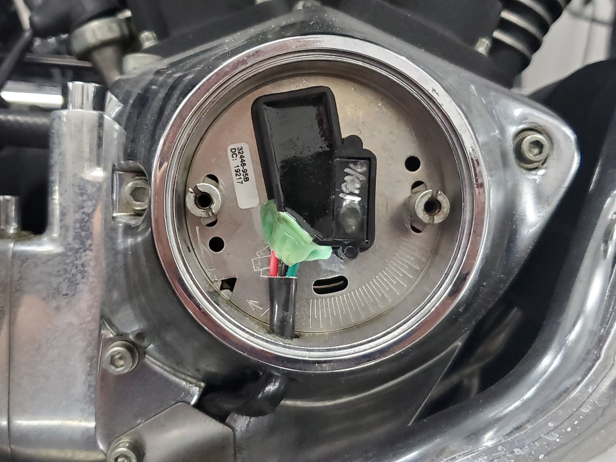

I think the OP still has a timing issue and he's getting kick back on the starter.. Time for a Dynatek 2000i..
Take a good look at your cam position sensor in the cam nose cone.. Is it original and is it spitting brown goo..? If so like I said time for a Dynatek...

They didn't. And I find it hard to believe that a cam gear would disintegrate.. The previous owner put 10k on the bike in the first couple of years he owned it then got sick and couldn't ride it but he wouldn't sell it. After he passed his daughter listed the bike with someone that knew I was looking for another Evo FXSTC and thought that it would be a good fit. Well with no oil splashing around in there for 15 years some corrosion developed on the shaft for the pump causing it to seize, pieces of the teeth on the cam gear snapped off and ended up bouncing around and caused other teeth to break off, they all ended up in the bottom of that compartment once I turned the bike off when I heard something pop.
I think the OP still has a timing issue and he's getting kick back on the starter.. Time for a Dynatek 2000i.. The mechanic working on my bike has suggested that I have the ignition module changed, I am willing to do that I was just trying to not change too many things at once. Since you are saying that you believe this is still timing related then I will have that changed.
Take a good look at your cam position sensor in the cam nose cone.. Is it original and is it spitting brown goo..? If so like I said time for a Dynatek.. It is original but as you can see in the attached picture it is very clean..
