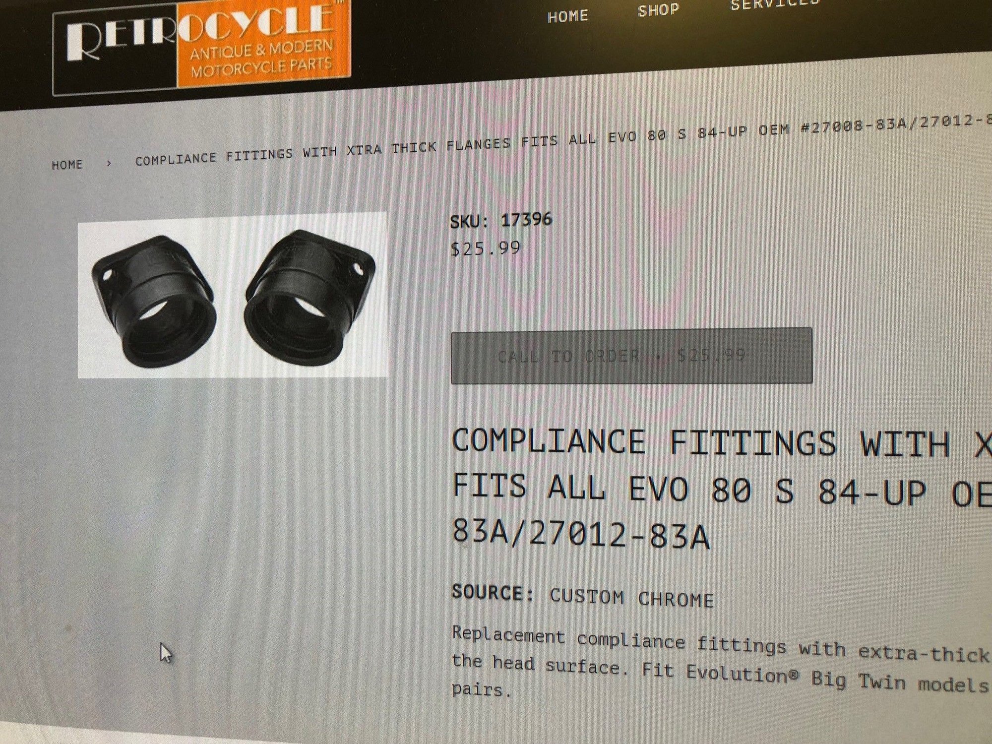

[QUOTE=Jake707;20465066]I not sure I understand what rubber mounting the carb means? Is there more than one way to mount the carb? QUOTE
Back in the day Evo`s had these

The problem is that the AC is solid mounted to the heads which means the carb is solid mounted to the head. The manifold side is OK It don't look like much but it made a big difference. Look at the picture. You can see the grommet. It don't look like much but it cured the main issue I was having.
