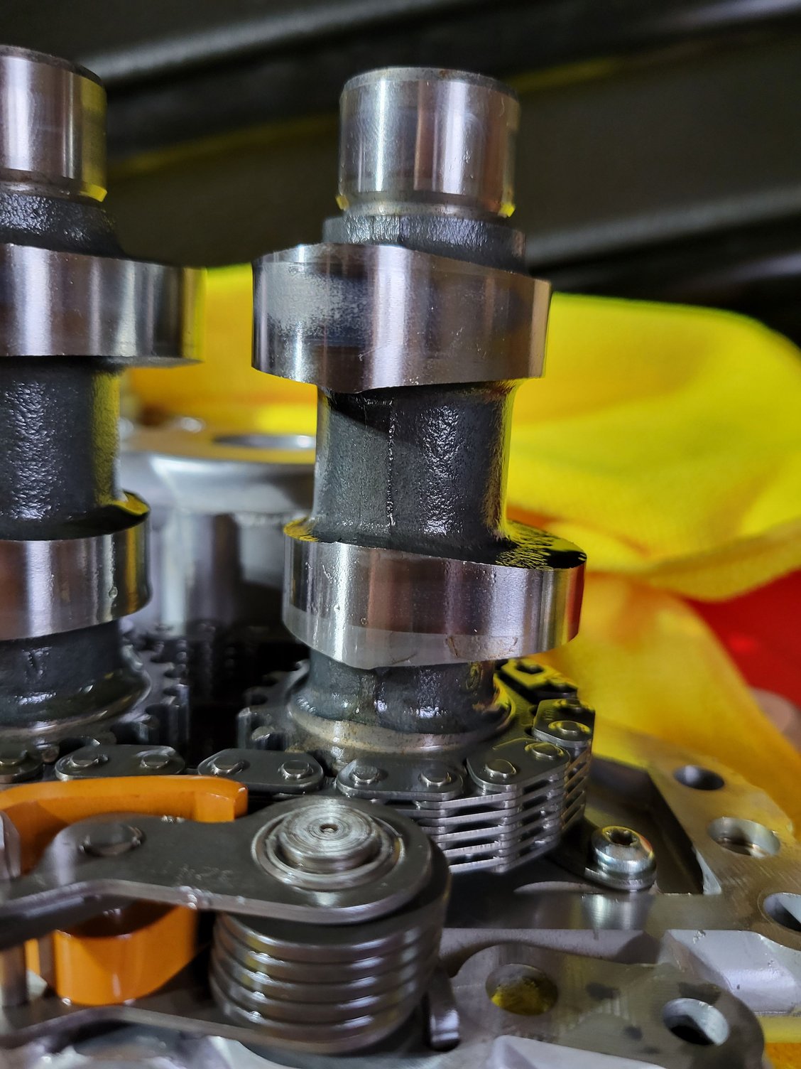

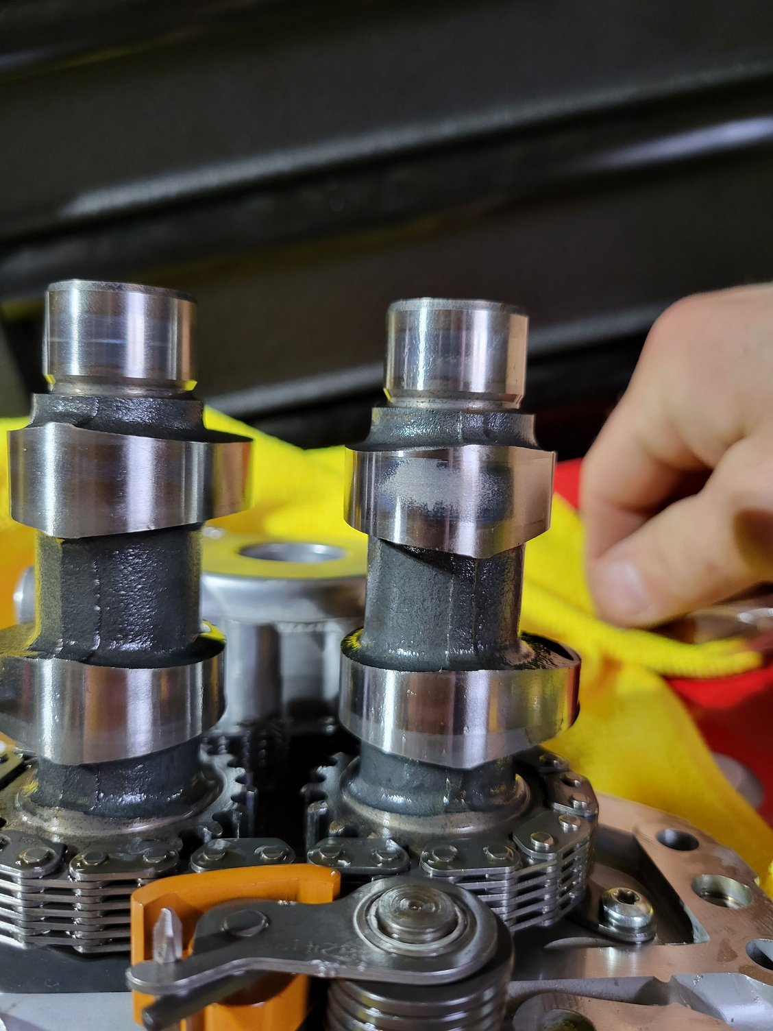

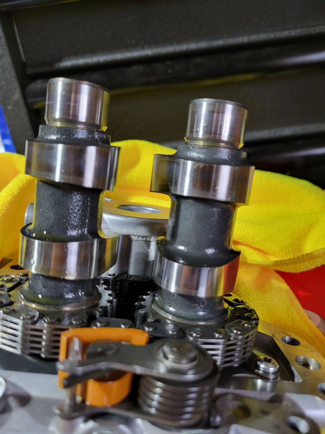

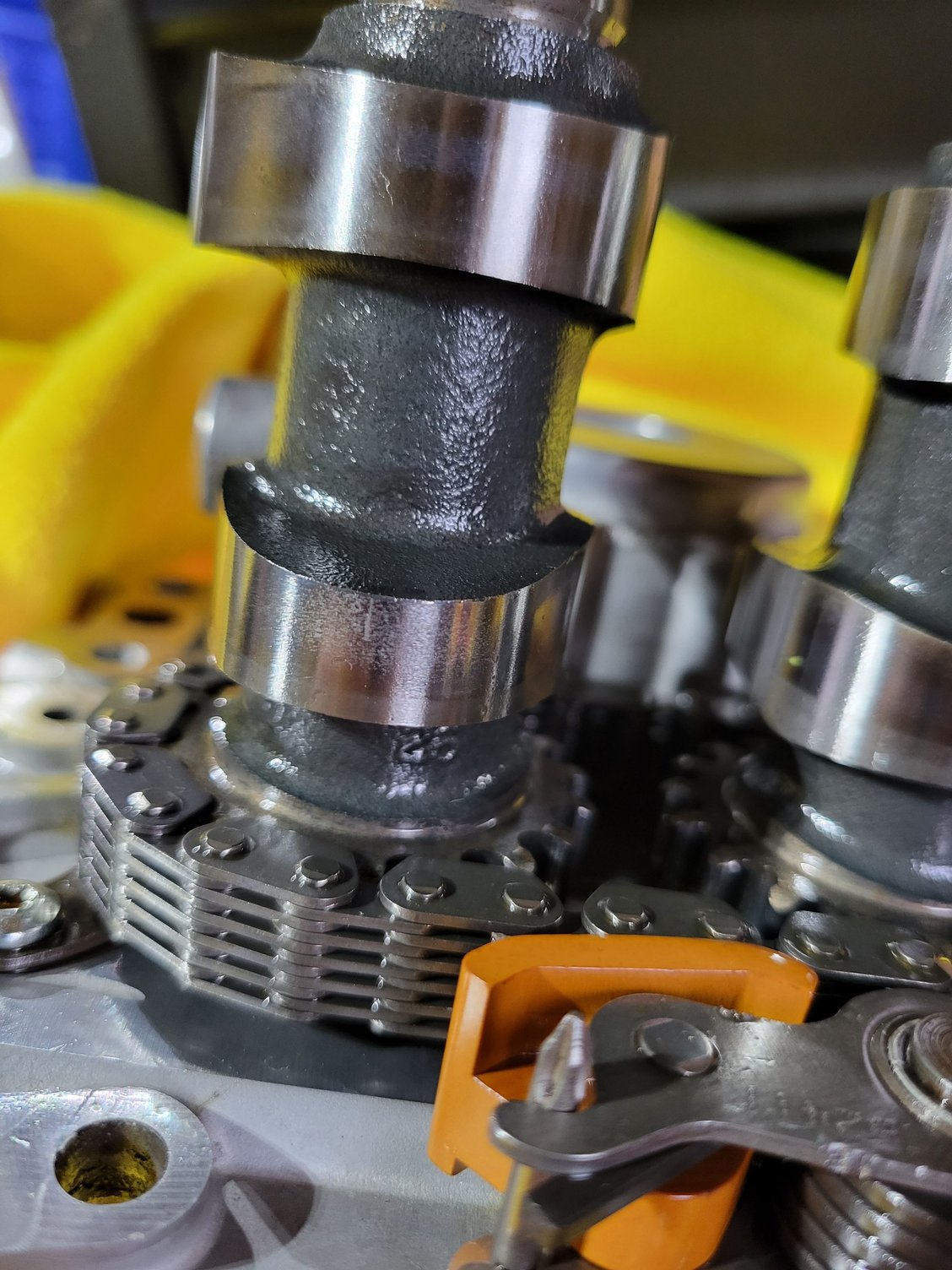

Got my 2000 wide glide cam chest tore apart to replace the tensioners, took some pics of the stock cams on the bike. Around 22,000 miles on the bike want to see what you guys think of these...safe to run? I already ordered new lifters from Larry's machine. The 2313 stock lifters, I'll be using my stock pushrods as well since I disassembled the rocker boxes to replace a leaky gasket. Also ordered Timken inner cam bearings as well

Nope. It's apart I'd upgrade them I was in there. Nothing crazy. Just a little more grunt is all. I'd also upgrade the cam plate to add the newer style hydraulic cam chain tensioners.

I'd be afraid those frosted lobes will prematurely put a hurting on the new lifters. I'm sure someone here has a decent set of cams you can snag on the cheap.

Intake lobe on the front cam looks pretty far gone

I have never put a stock cam back in any motor that had been dissembled enough to have the cam in my hands. Once removed, stock cams go on the shelf, not back in the motor. Don't go crazy, just a little more is good enough. Good luck.
