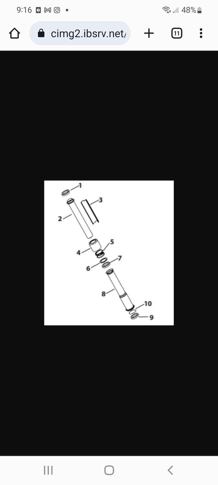

Ok, after another dissassembled look at pushrod covers, the center oring, that goes under the spring, in cap, that seals cover is missing!!??? Why tf is the question now? What did someone else do or does Harley factory not install these anymore???

There isn't any O ring that goes on top of the spring.. It should be O ring, washer, spring , cover.

I meant under the spring on top of lower cover #7 o- ring
