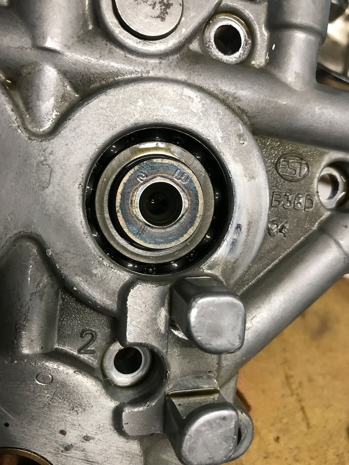

you could always trace previous owners back and talk to each one. Also pulling the cam cover to check the front of the cam that goes through the cam plate isn’t to hard. You might have to pull the bolt on the cam gear, but shouldn’t have to pull the gear and timing chain itself. You should see the markings on the cam like this

Thanks. There was only one previous owner but found out he lied about a couple of things. One was he said there was an FP3 on bike used for the stage one tune. Well there was an FP3 on bike but it was registered to a different bike so I tossed it and had to buy a new one. I’m thinking maybe I could just check to see if the push rods are adjustable. Just got to figure out how and best place to look for threads.
