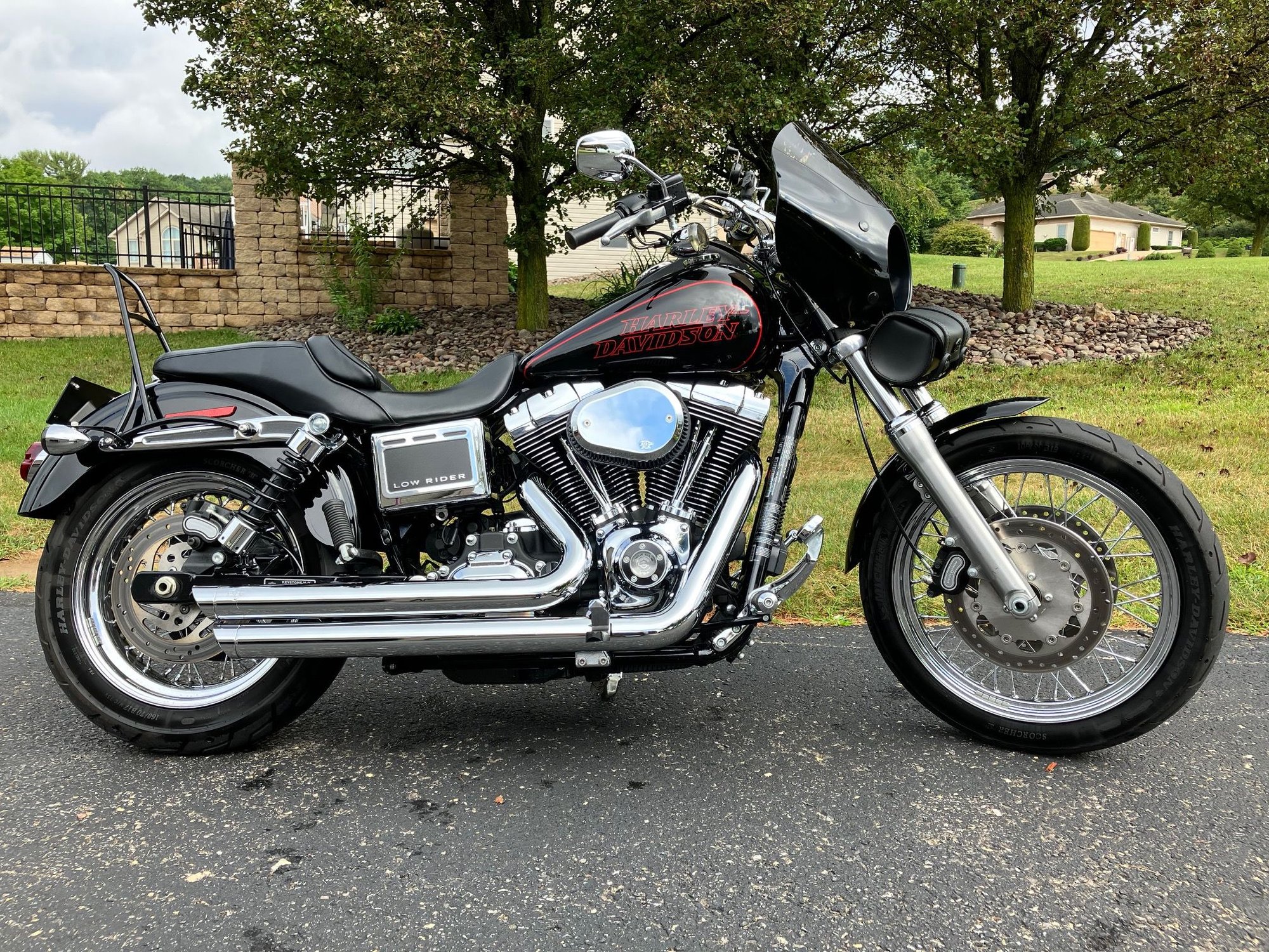

With that cyclerama cam, can I use the stock solid pushrods and also for a 48H andrews or 222 woods? I am planning on going in from top so don't wand to deal with adjustable push rods. I guess base circle has to be same which I think it is with most of these bolts ins.

IIRC, the 570-2 base circle is the same as stock but the Andrews 48 and Woods 22 base circles are .020" smaller than OEM which would require adjustable push rods. Suggest you call Wes Brown and Cyclerama to confirm the 570-2 base circle to be sure; I am relying on memory which is subject fail as evidenced by a couple of my posts o this forum.

Your memory was correct. 570 2 Same base circle as stock according to folks at Cyclerama. Thinking of doing rockouts while I have top open. Do you have a thought on them? Thanks for all the advice.

Thanks, wasn’t sure if maybe there was some kind of negative. So far looks pretty good for that cr cam. See guys happy with them on even touring bikes so they should turn a dyna into a real stump puller.

Question I now have supertrapp 2 into 1 fat shots on my 103 with KN free flow air filter. Supertrapps run those disks on them. I have like 18 of the disks on system. Do you know if that combo is free enough to make a cam worthwhile? I ask because my last pipes were Vance Hines big shot staggered and they were way louder.
