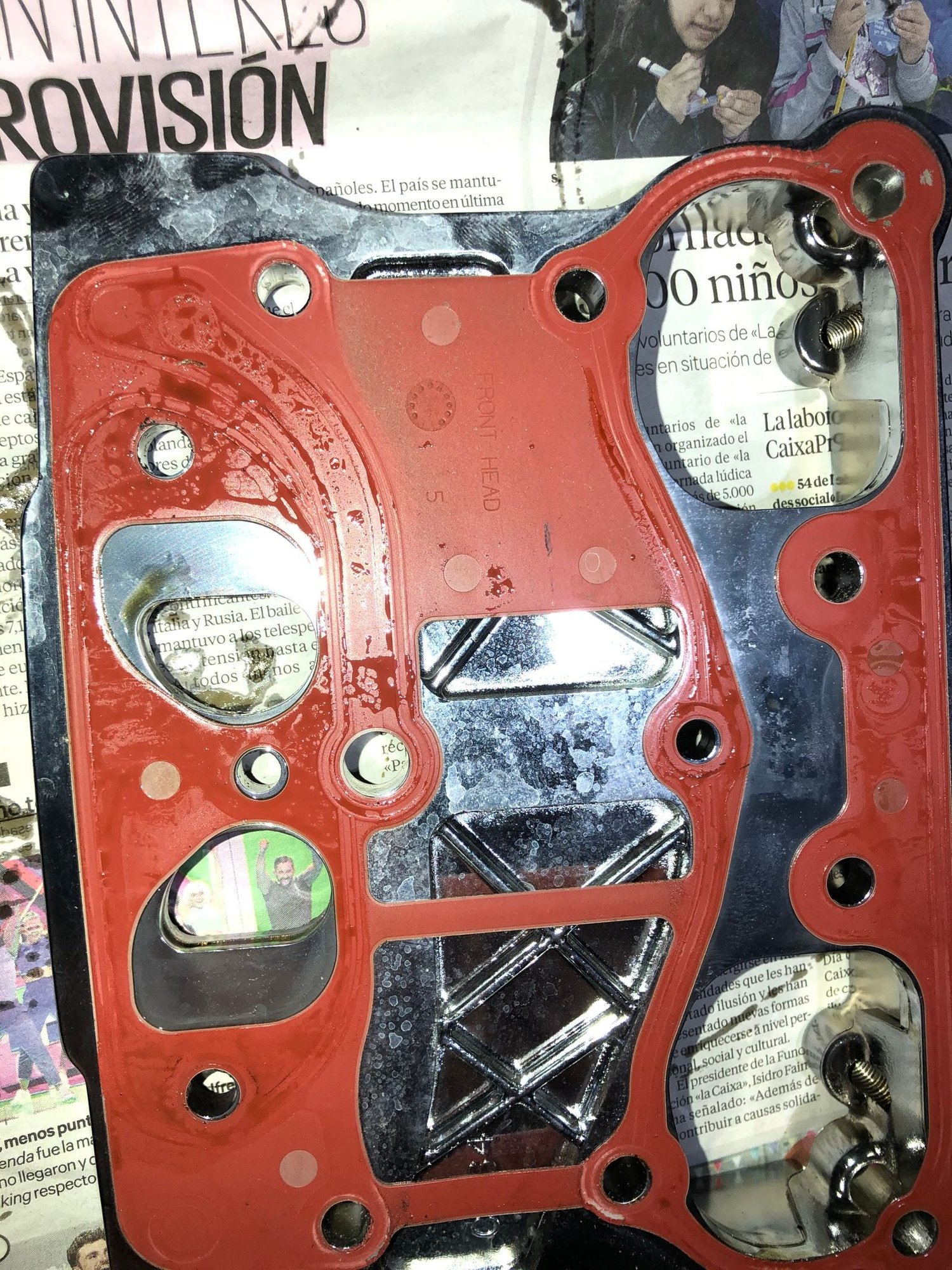

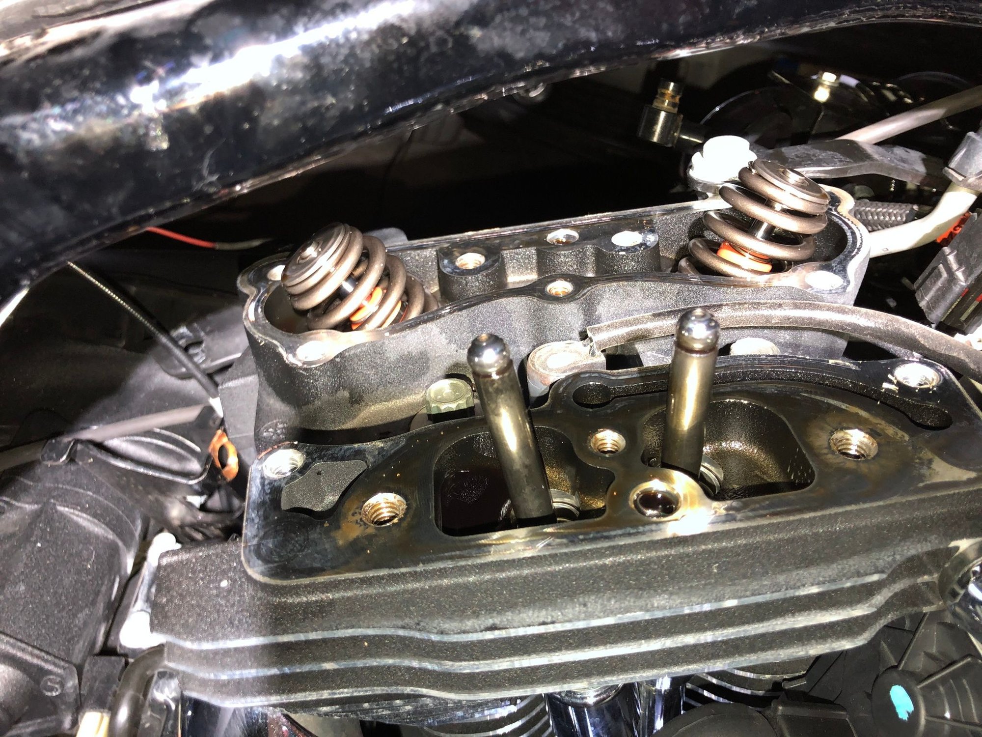

I've change the rear rocker base gasket without drain coolant on my father's triglide.

Old Sep 9, 2022 | 03:17 PM
