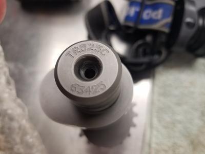

Most aftermarket cams are ground by Andrews and, for that reason, most aftermarket cams have the vendor and cam numbe stamped on the exposed nose of the cam like the TMan 525 chain driven cam in the attached photo.
There may be enough of the ID exposed on the front cam to see it but it can be hiddent behind the rear cam chain sprocket and the sprocket will have to come off ot see the cam nose.
