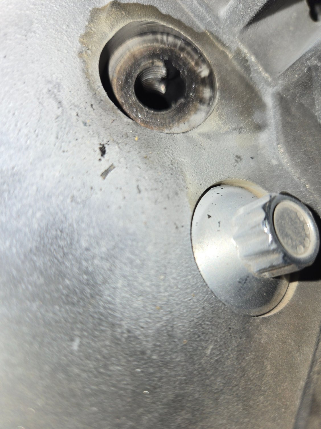

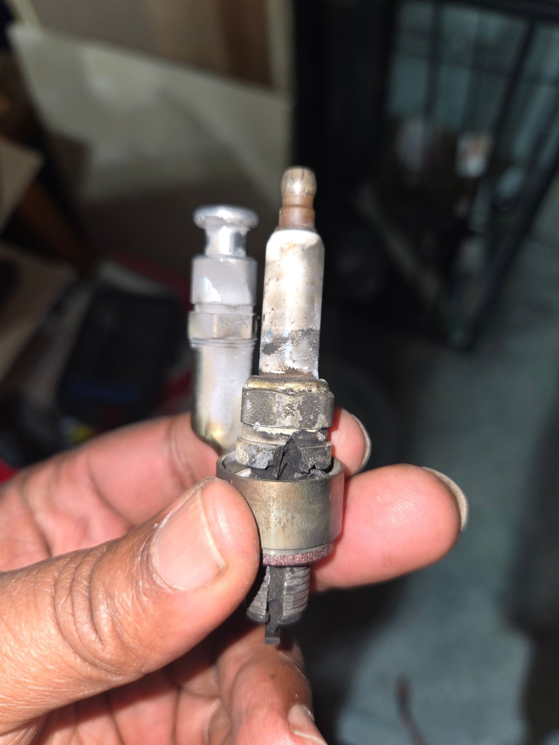

Old Apr 1, 2024 | 02:04 AM
Broderick Crump's Avatar
Broderick Crump
Stage II
Joined: Jan 2021
Posts: 2
From: North Carolina
Default Compression release
I'd be leary of that groove in the plug threads, can see that going wrong a couple ways.
I used it and I guess I had a bad one and it blew some of my threads off my read head and messed up the piston n jug in the process
Old Apr 1, 2024 | 04:21 AM
TwiZted Biker's Avatar
TwiZted Biker
Joined: Mar 2009
Posts: 66,114
Likes: 51,396
From: Niles Canyon Ca.
What I figured would happen, bummer man sorry you got tagged.
