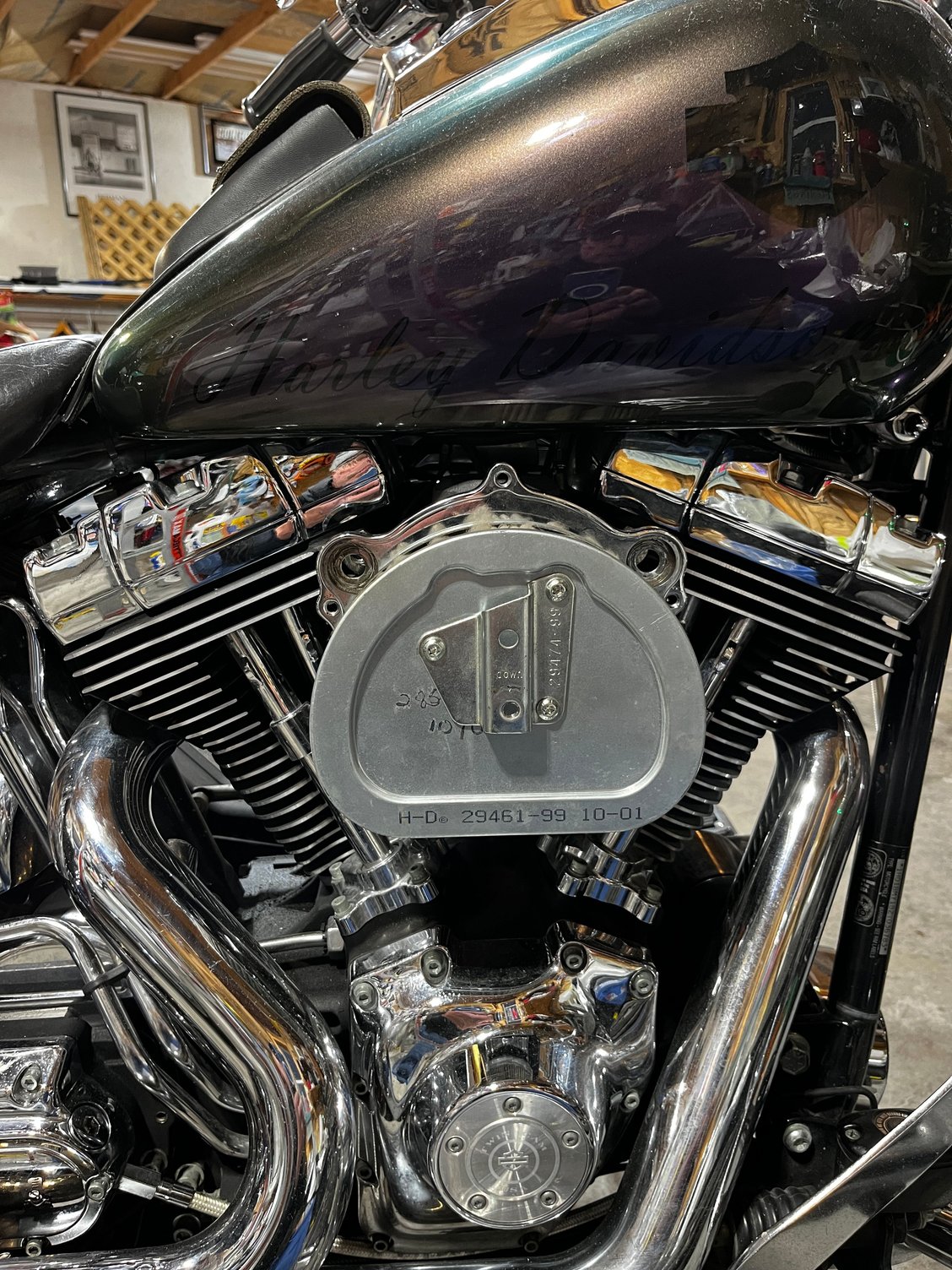

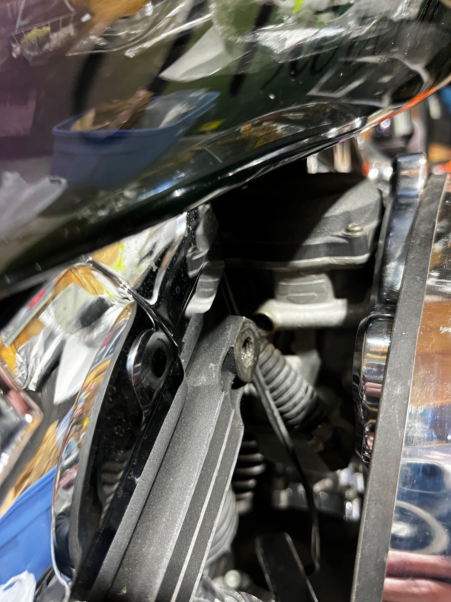

Big thanks to Screamin beagle, djl and now DK Customs. Thanks to the suggestions I took the backer from a Roland Sands turbine air cleaner that just came off the bike. I did remove those integrated rubber vent tubes before installation on the bike. Was able to mount a stock paper filter that was on hand with the cover bracket. Lo and behold the stock cover now fits. As the last photo shows, plenty of room now for pretty much anything I want to use for crank case breathers.
I was considering staying with a paper filter but will probably get a washable since I've got plenty of cleaner and oil on hand anyway.
Note to DK - the bike has actually had vents on it since probably 2005. Braided steel that vented down to the ground. But after all these years they're pretty ratty looking. Since you chimed in to help I went ahead and ordered a new breather kit as a thank you.
