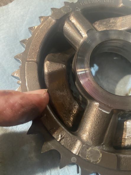

3 complete sets

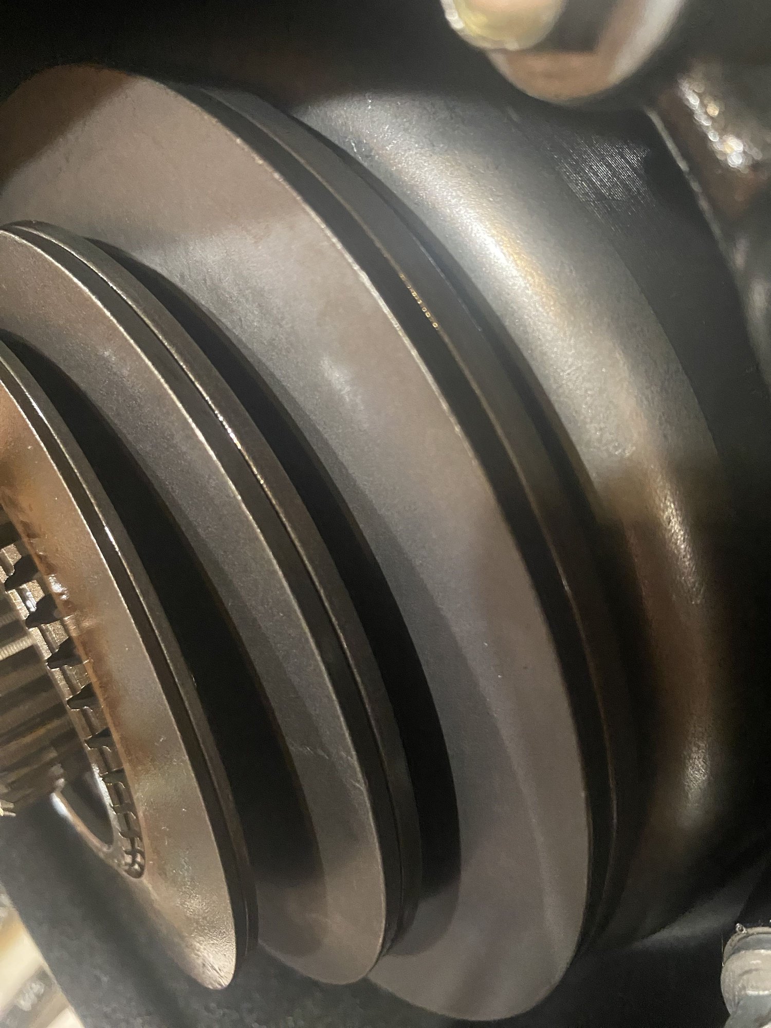

When the springs are weak the sprocket will slide all the way up the ramp... this is bad because it goes both ways... almost a 2" slack!

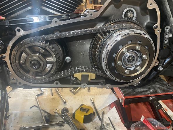

my setup... yes my tensioner is a little snug, it just needed seated in.
Currently 25k miles no rattle, no starting issues!

Talking Wear info...
For the non-mechanics ---- The second picture with the ramp and sprocket, that's where the steel on your magnetic drain plug in the primary comes from.....
