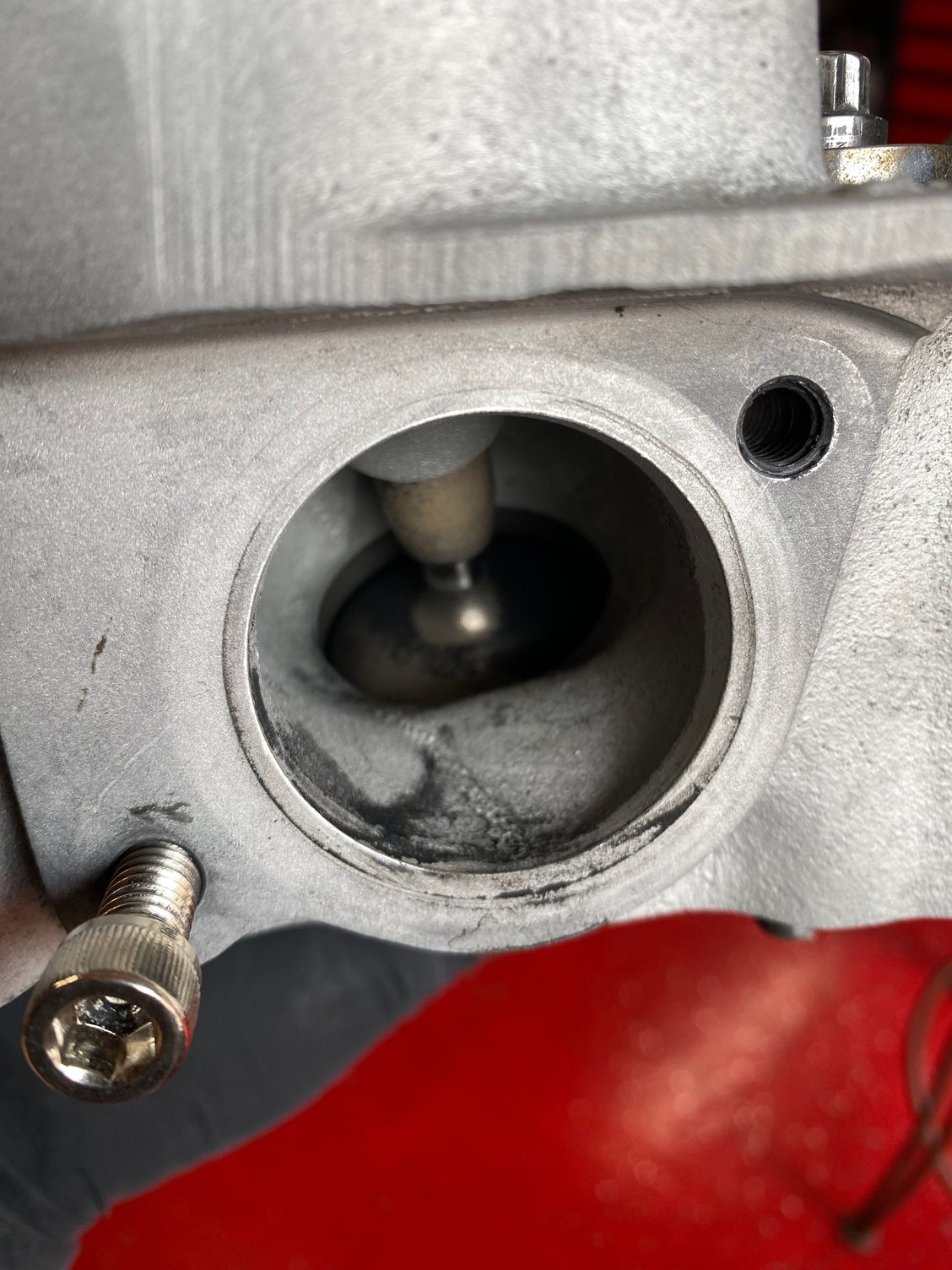

At least the seals but from the amount of oil I see I'm leaning to well worn guides. Look in the ports on the heads, are guides themselves wet looking ?

I don't think its oil. The valves are dry inside other than some soot on the exhaust side. Excess gas?? It all cleaned up easily.
Here is the intake port.
Here is the exhaust port front cylinder
