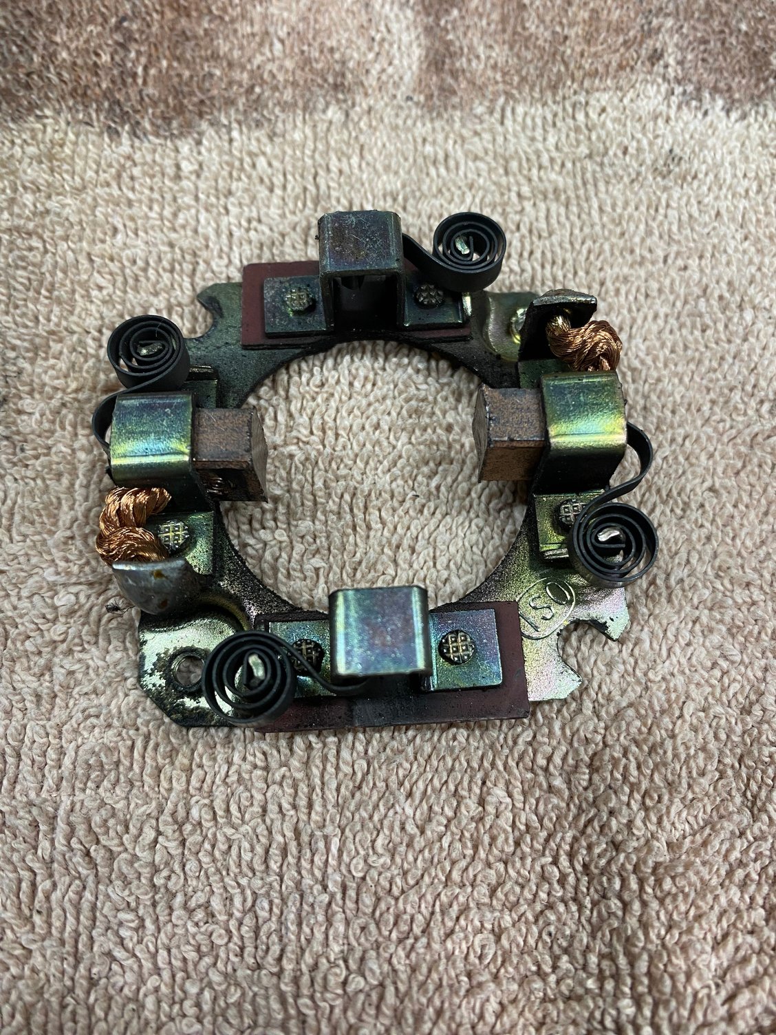

Here is the starter broken down. I'm leaning toward a new starter and yes I know most are made in China now. But at 38 yrs old I'm not sure I can save this unless someone here can convince me. Gonna run some quick tests per the manual.
Ride safe!

That starter is cherry compared to how I usually see them, plenty of brush left and no serious pitting or armature wear. Blow it out with a little brake clean or air line, lube the end cap bearing and run it.
That thing is clean.

If you want you can take a little emery cloth to the armature where the brushes ride.. Otherwise as TwiZted said.. Looks good..
