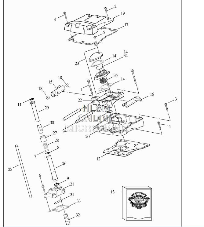

Head gasker replaement is pretty straight forward but would recommend getting the HD service manual and parts manual as well; both are pretty useful. You can pass on the parts manual and use Ronnies Parts Finder to see isometric drawings which can come in handy if this is the first time.
See the attachment. In addition to the head and exhaust gaskets, should that need replacing, suggest replacing the gaskets and o-rings shown in the attachment. I have re-used studs and head bolts with no issues. The attachment is an earlier model with rebuildable head breather assemblies which can be replaced with the later stamped head breathers which are supposed to be more efficient; only $12/each. IIRC, the stamped breather "upgrade" came in the '10 or '12 model year. Also attached is the link to Ronnies where you can search the later years and get the PN for the stamped breathers if you want them.
If you are careful removing the head you can avoid disturbing the seal at the cylinder base o-ring. Once the head is removed, use a 1/2" PVC coupling or a stack of washers to secure the head so you don't accidentally disturb the base cylinder seal. That will save you a lot of work if you don't have to remove the cylinder to replace the o-ring between the cylinder and motor case.
