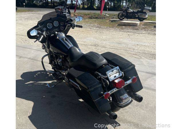

I just bought a 2008 FLHTCU with 80,000 miles for $4k. Seems to run great and I got it for an awesome price. Last weekend I went to the PUMPKIN & PAINT @ the Garland HD dealer. Where I talked to the service desk super nice man.
Suggested I get the 20k service with cam guide inspection for $1,300. Where he told me I can't flush my brakes with out the PC due to ABS, and the cam guides wear out at 40k. The service intervals states nothing about cam guides.
It this worth the money or is he just trying to up sell me. Looks like I just need one gasket and to remove a half dozen bolts or so from looking at the service manual.
