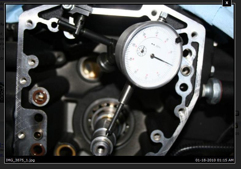

One way to do it attached; different ways to securely attach/mount the dial indicator. The steel plate that comes with the innner cam bearing R/R tool makes a decent base for mouting a magnetic base for the dial indicator.
Also attached is a primitive jug to mount a dial indicator. I have cut up an old cam plate to check runout but don't have a picture. Imagine cutting off the top of the cam plate; just below the bearing bosses, driling a hole centered over the brass pinion bushing for fixing a dial indicator; Google Fueling Crank Runout Tool and you will get the picture.

Similar to this;
