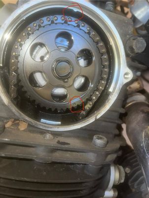

Hi,
I'm trying to adjust my timing chain and I have a simple question. Let's say I adjust my rear cylinder first, it's lined up perfectly with the guide marks, but on my front cylinder it looks like it does in my picture where it's not lined up because the mark on the camshaft is at the bottom and not the top; is this normal? Are both supposed to be up top and lined up at the same time?
Thanks,
B.

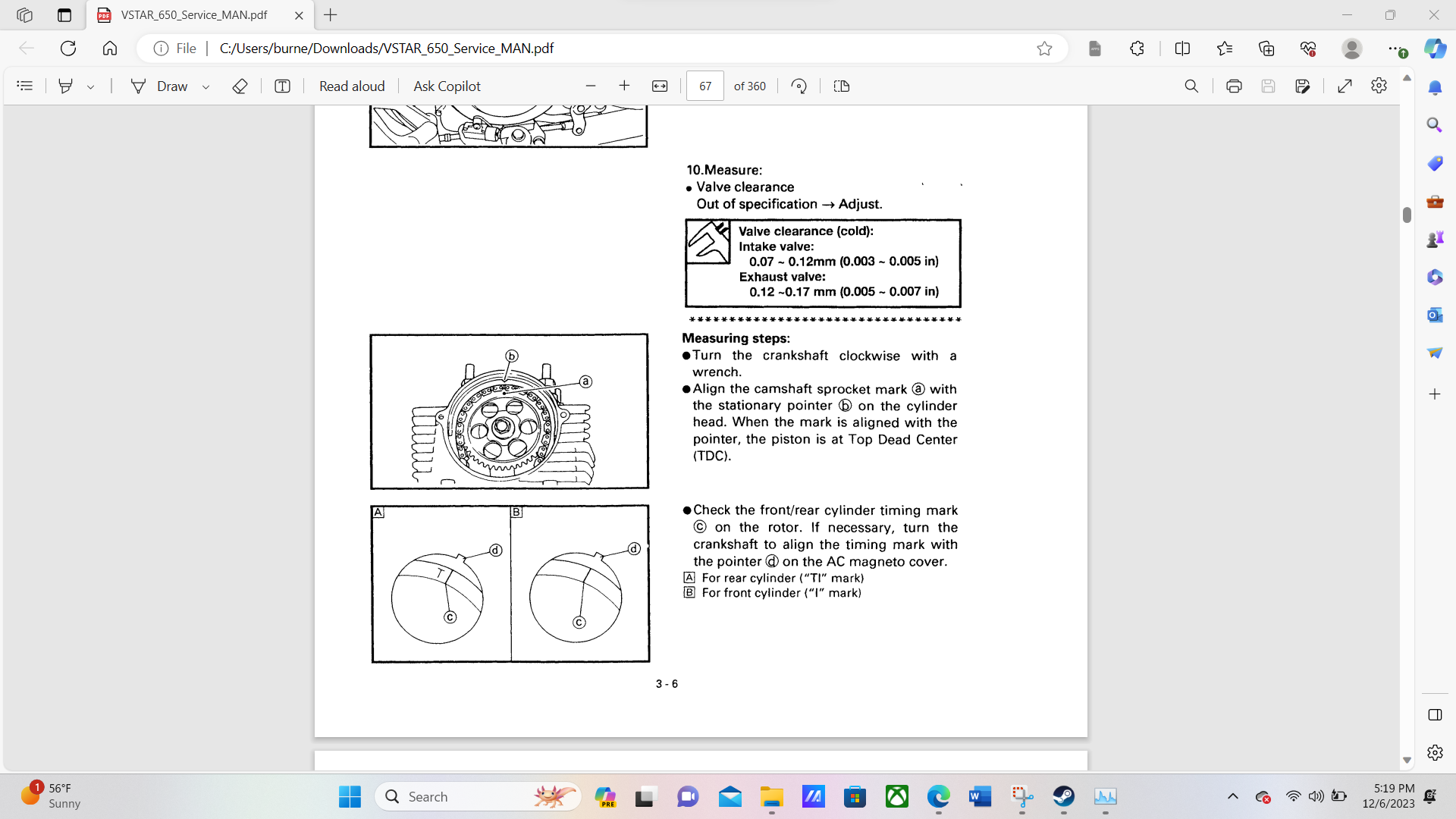

You really need to be on the Yamaha forum. But unlike a Harley, your twin does not share a single crank pin. I had a 1100 V-Star Custom . My son had 650.
I only adjusted the valves. I assume that's what you are doing since what you show is not adjustable manual.
Think it's saying top dead center and your cam mark aligned after cylinder one is probably two turns of the crank at other line will aline cam again.

Turn the CRANKSHAFT one more full rotation. Where does that mark land, then?
That manual is listing the valve adjustment procedure, no? You said you were adjusting the the timing chain?

If I turn it one full rotation it will be lined up almost perfectly with that marking "I" on the crankshaft, but then on the other header the mark on that one will be at the bottom; that's what I'm confused about. Appreciate the response.
