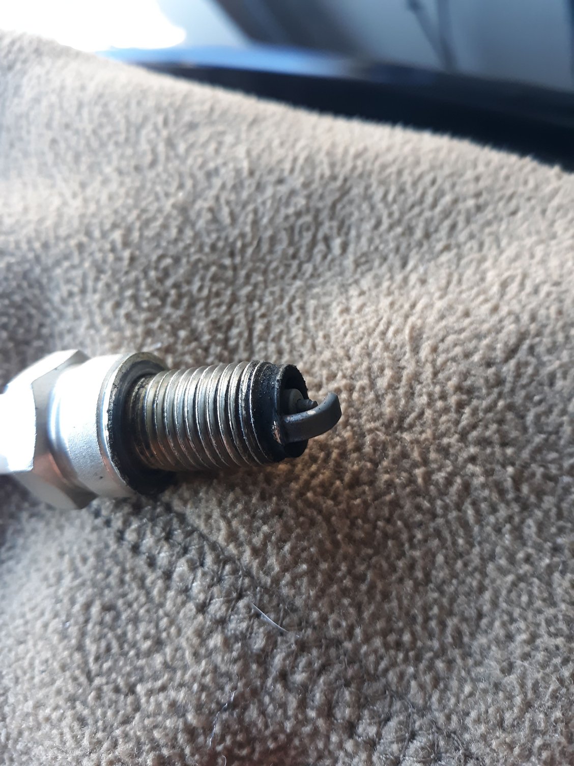

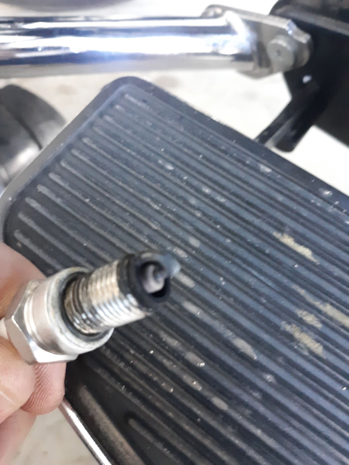

01 road king carbeurated, been playing with timing a bit on the thunderheart ignition.
Can anyone tell anything from these plugs?
Thanks

Mikuni HSR 42. Looks good, what jetting are you running? Do a search for joe minton evil tryant blog. The Wizzard of Mikuni and others.

Looks good to me. Little worn.
Put a new set in and drive it 50 miles for an average of how you normally run it. Then read that.

Hard to say from the pics if it's oil or fuel or a little of both but a little rich at idle. Can't see the timing on the ground straps from the pics either. Probably valve stem seals? Not sure what they used that year or if they've been replaced. 05s had notoriously bad ones with premature failures. Either way to be expected in an engine this old. I don't see anything to be overly concerned with tho. Pretty good from what I see.

The first set of pictures look completely different than the second set. In both cases, I read a tad rich, particularly on the second set; maybe go up one step hotter and timing mark on ground strap is hard to read in the second set but first set looks like the OP could back off timing just a bit.

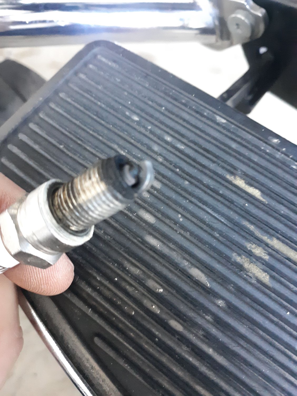

Here's new pics after going one more notch advance on the timing.

Nice rich plugs. Now go jet than damn Mikuni.

Not sure what jets are in it currently, I haven't changed them since I've had the bike.

Go look up that Joe Minton Blog on Mikuni HSR jetting. Mikuni jetting runs a fail safe rich condition which is easy to correct with a little tuning.
