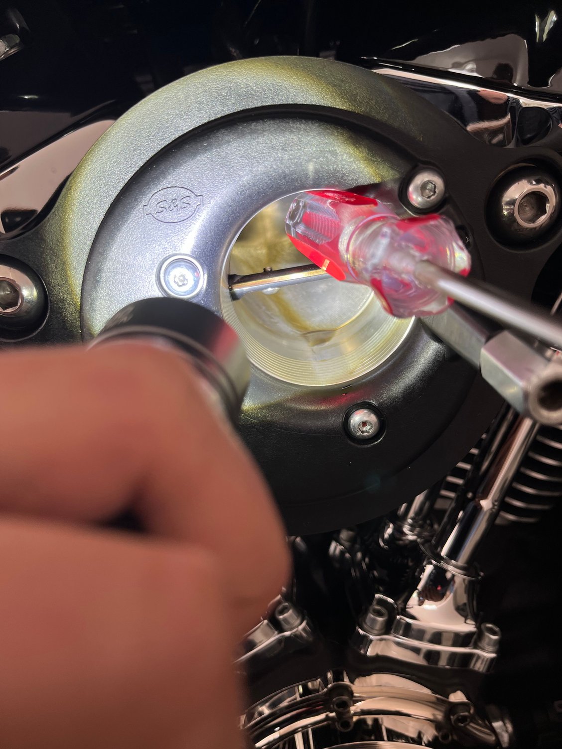

This may make sense and my thought. Even if I ran hoses from breather bolts out of TB that amount of oil is still concerning in the first place. I broke it in by riding it with a Fuel Moto tune. I also ordered the Dynojet Target tune as there’s no good tuners around. I was really hoping it’s not the rings , if so will have to dissemble everythin again. I was trying to see which head it was coming from and when I cleaned it and looked in with flashlight I think it may be coming from front cylinder. I will have to run it and look again. Also not sure if I mentioned I do have the Trask vent cover

So I ran it again and to me and these pics it looks like oil may be coming from front cylinder. Thoughts? But also I noticed back of TB butterfly is little wet. Thoughts?

How does it run? any problems besides seeing oil in the TB?

It could be as simple as the breather assy in the front head isn't working as it should.

Runs great actually, and use my PV to monitor engine temp which hasn’t exceeded 275. So that seems ok. Im wondering if its a ring issue on front cylinder? But from the video and pics, to me at least looks like oil oozing from front cylinder .
