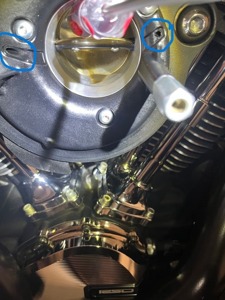

The Trask unit helps vent crankcase pressure to atmosphere, but the oil comes from the crankcase breathers in the heads- see the two holes i circled in the backing plate?
That's the source of the manifold oil. You can modify the backing plate, or use a different AC setup, that routes that air/oil mist to a catch can. Running the oil level about 1/2QT low can help with this also.
