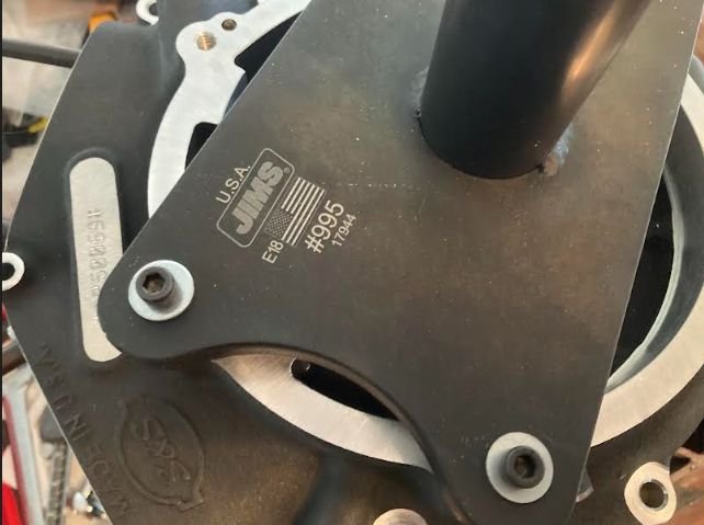

I use the Jim's USA tool to press the case apart.

I thought there was two pry points (front and back) you can stick a large flat screw driver in... and wiggle it open. That jims tool is so over priced, it's not even funny. Wish George made something like that, but they don't.

I thought there was two pry points (front and back) you can stick a large flat screw driver in... and wiggle it open. 't.
I saw a video with one. But could not find it on, my 2007.
