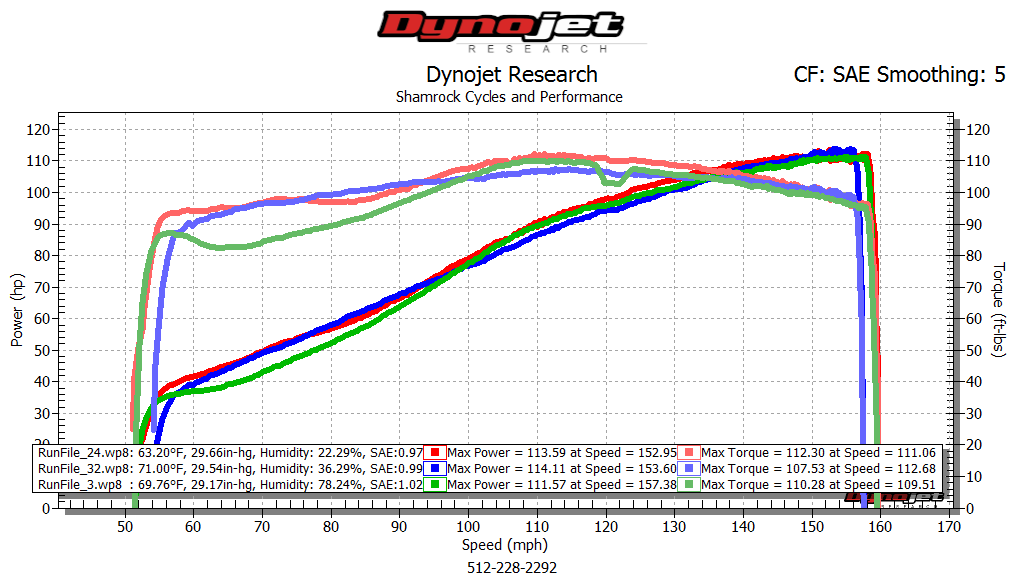

So the Bassani Pro Street True Duals perform just as good as a Bassani 2-1?
I am betting they don't and offer that as proof of the general statement that true duals are not top performers regardless of brand.
Now if you have real data that shows Brand X true duals are the performance equivalent to Brand X 2-1 or even 2-1-2s, then I will thank you for the lesson learned.
Originally Posted by 60Gunner
Not entirely true. The Bassani Pro Streets will do as well or better than most 2in1s or 212s out there. This has been proven more than once. I agree about the Rinefarts tho. Most TDs do suck. But not all.
Proper length, diameter, and placement of steps is the difference.
FM actually sells them now, btw.
Below is a link with a direct comparison on the same bike belonging to djl and tuned by Nick at Shamrock. It's why I chose them in my 107 build doing 127/126. Like djl, I don't care for the looks, sound, and hiway drone of a 2in1.
Actually, depending on which 2in1, the Pro Streets will perform way better. Especially the short, megaphone one.
A 2in1 isn't good just by virtue of being a 2in1. Way more of them suck than are good.
True duals don't suck just because they are TDs. But very few manufacturers spend the time and money to make them perform well. The right length, diameter, and placement of stepped duals will outperform most pipes.
I can tell you there are very few 2in1s that will do what the pro streets are doing in my 107 build. While the low end isn't their strong suit, there is no reversion dip like a lot of 2in1s would have and most TDs have and the Pro Streets make awesome mid and upper rpm power. More than many 2in1s would. How many tc 107s are there doing upper 12Os squared? You will find most all of them struggle to hit 120hp. How many 98 builds are doing 118/116? Not very many that's for sure. I've seen one other.
2in1, 212, 2-2, it doesn't matter. It's not what makes an exhaust good or bad.
I use to think the same thing about TDs. Not anymore. I run the Pro Streets in my max effort 107. If they sucked they would be gone in a heartbeat.
Here's the 98 build. Red is the Pro Streets, Green the Fatcat, Blue is the Python, an older version of the pro pipe.
