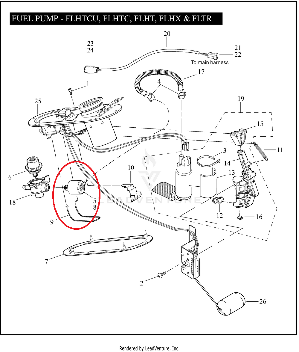

1. Clogged injector that cleaned itself?
2. When was the last time the fuel filter was changed?
3. Fuel filter is 17 years old, how many miles on it and how much fuel has gone through it?
