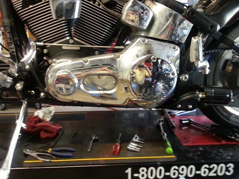

I used the Moore kit to move the filter to the rear under the passenger foot peg. The supply and return lines hold a bit more oil, not much but a few ounces and not saying that is justification for relocating the filter which was purly for the convenience of changing the filter. Adding a Jagg 10 row oil cooler will help recuce oil temps. Doesn't get as hot in south Texas as AZ but it goes get pretty hot with more humidity. Its hard to really say how much the Jagg cooler helped in my situation but I believe, conservatively, it was at least 10* on the hottest of days.
