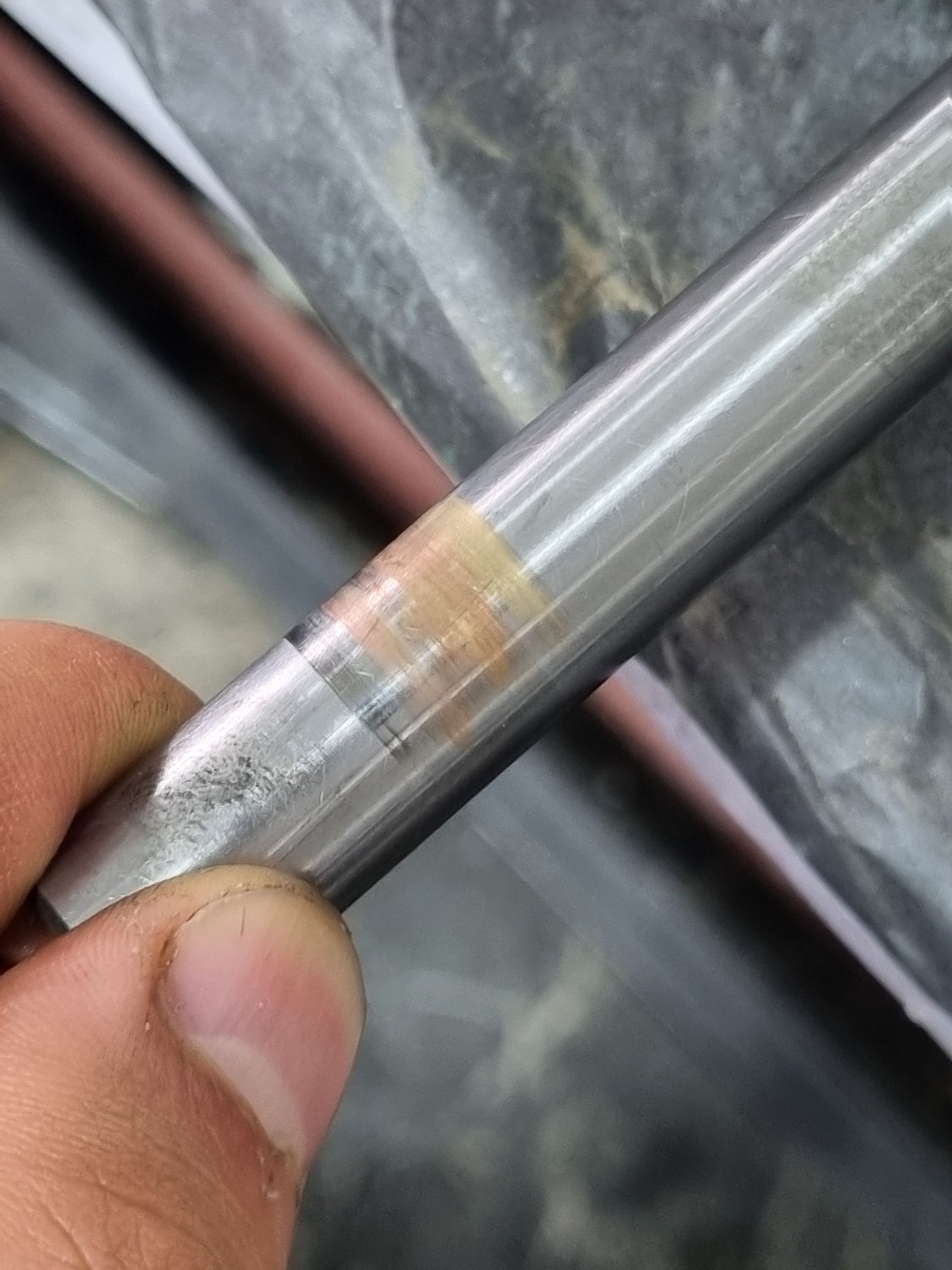

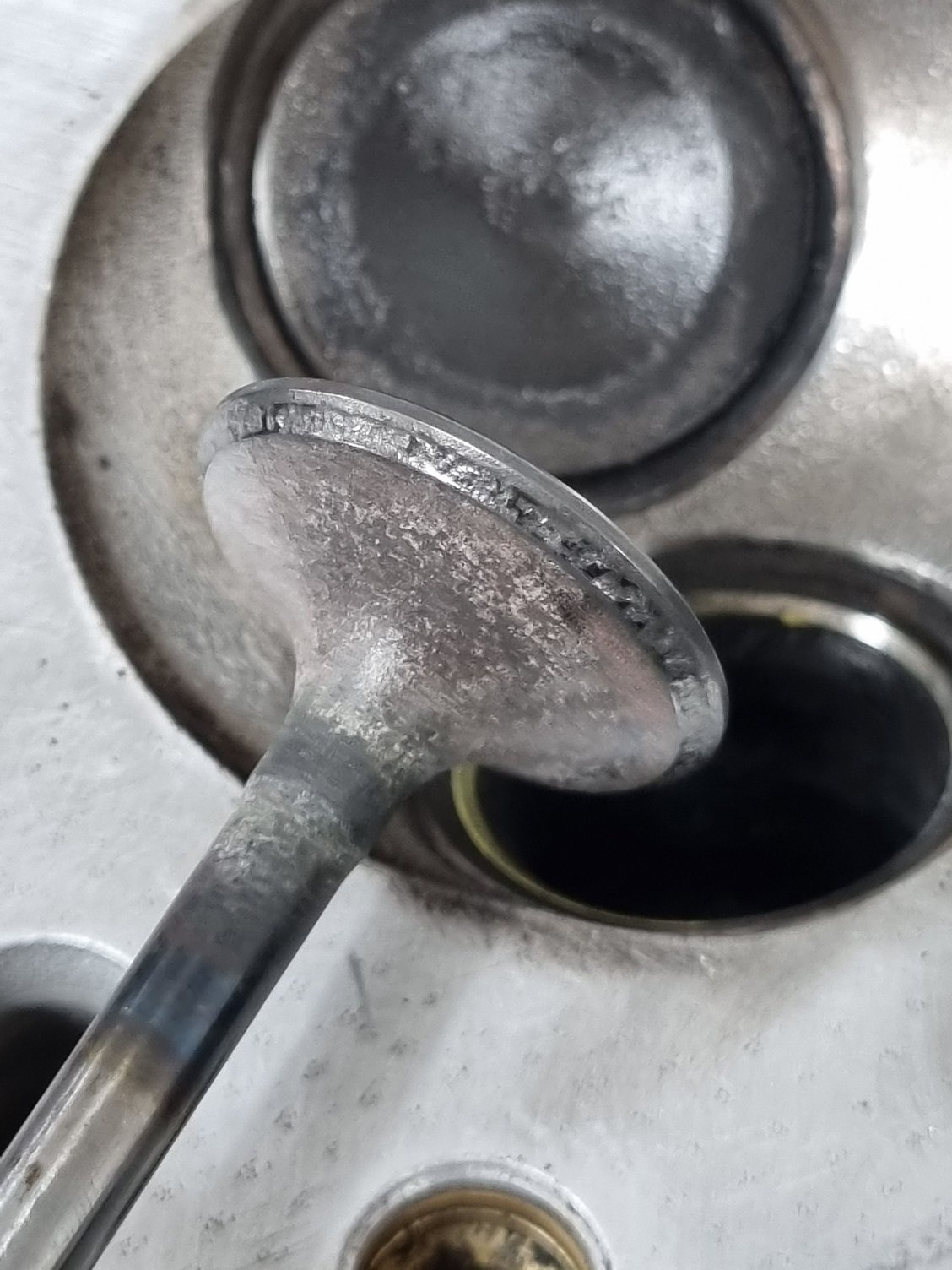

Recently took the top end off and found one of the valve was scorched pretty bad and had it replaced. (Refer to the photo) Also replaced all four lifters with comp cams lifters(ds1003). There is no bent or significant wear on the pushrods as well.

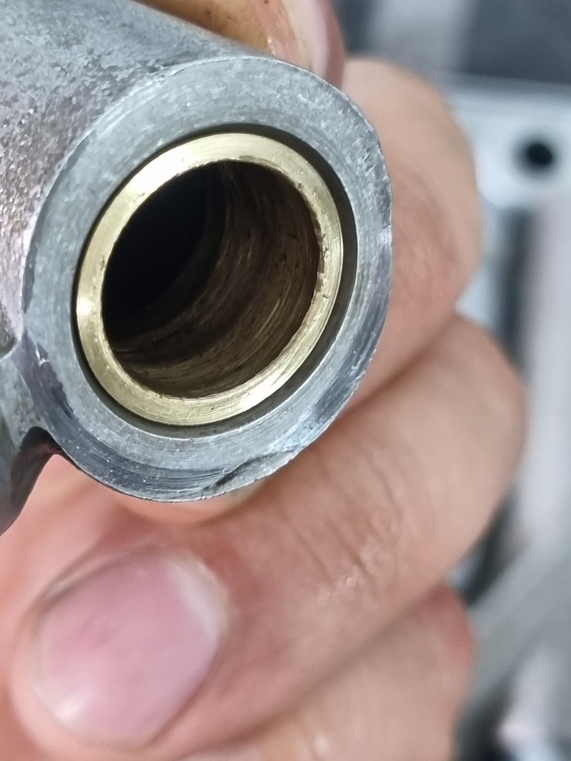

Oil pump was recently replaced and oil pressure is fine in the range of the service manual even when the noise is present. Found a little wear on rocker bushing and had it fixed also (photo).

the spalling of the valve suggest very lean fuel mix, ignition timing too early, detonation or high heat.
need to check for bad lifters, timing advance and base settings and fuel quality.
also check compression

The problem with that valve could easily be from the bike sitting in a humid environment or water getting into the motor through the intake. Rust ate the valve. Another way would be stating the bike and not riding it.

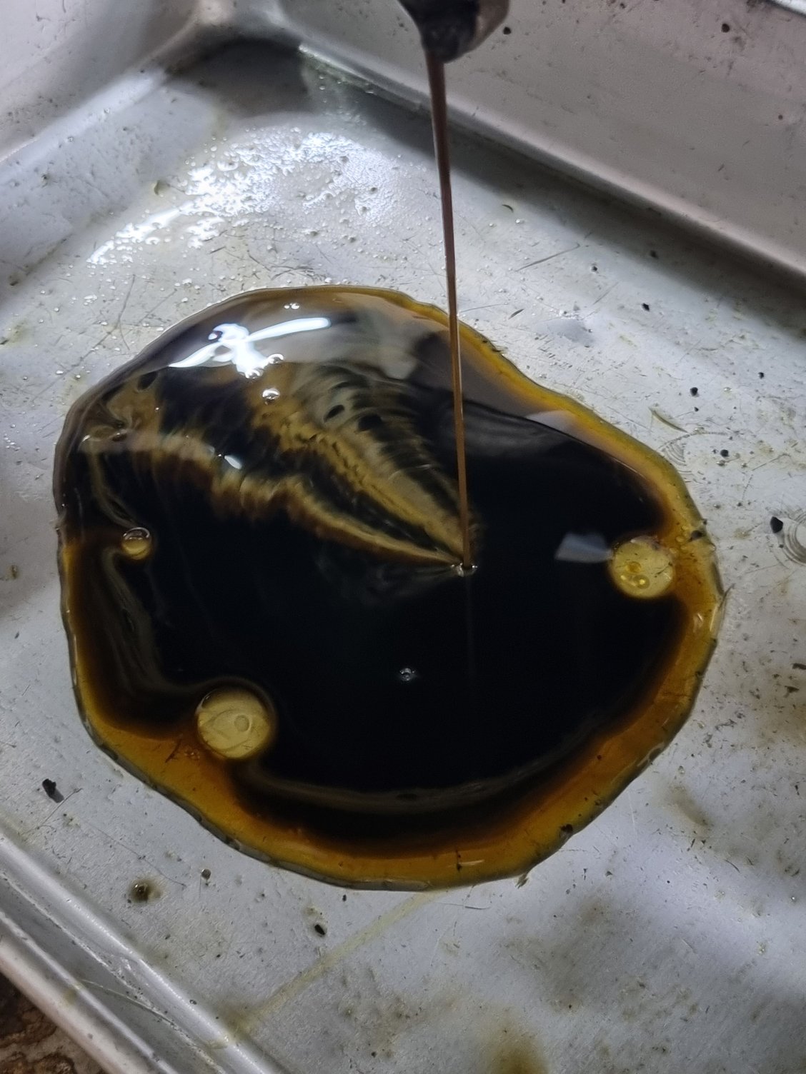

I dont think the it sat for that long but on the last oil change some water was mixed in with the oil.
